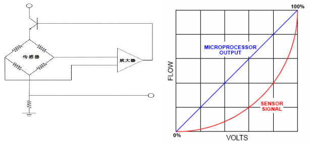

ÈÈÊ½ÆøÌåÖÊÁ¿Á÷Á¿¼ÆÓÐÒ»¼á¹Ì¡¢¿ÉÇå½àµÄÈÈʽÖÊÁ¿Á÷Á¿´«¸ÐÆ÷×éºÏ¡£´Ë×éºÏÓÉÁ½¸öRTD(µç×èζÈ̽²âÆ÷)´«¸Ð×é¼þ×é³É£¬Æä²ÄÁÏÊǾ«×¼¼¶²¬µç×èºÍÌÕ´É¡£Á½¸ö²¬µç×è´«¸ÐÆ÷¸½ÓÚÌÕ´É»ù°åÉÏ£¬Íâ¼Óһϸ³¤µÄ²»Ðâ¸Ö±£»¤Ìס£´Ë´«¸ÐÆ÷×éºÏÊÇζȲ¹³¥µÄ£¬ÇÒ¶ÔѹÁ¦±ä»¯²»Ãô¸Ð£¬ÎÞÐèѹÁ¦ÐÞÕý¡£Á÷¾­¼ÓÈÈ´«¸Ð×é¼þµÄÆøÌåÖÊÁ¿Á÷Á¿ÊÇͨ¹ý´«¸Ð×é¼þµÄÈÈ´«µÝÁ¿À´¼ÆÁ¿µÄ¡£ÆøÌåËÙÂÊÔö¼Ó£¬´«¸ÐÆ÷´«µÝ¸øÁ÷ÌåµÄÈÈÁ¿Ôö¶à£¬Òò´ËÐèÒª¹©¸ø¸ü¶àµÄµçÁ÷£¬ÒÔά³Ö´«¸Ð×é¼þµÄºã¶¨Î¶Ȳî¡÷T¡£´ËÈÈ´«µÝÕý±ÈÓÚÆøÌåÖÊÁ¿Á÷ËÙ(ÃܶÈ*Á÷ËÙ)¡£±äËÍÆ÷Êä³öµÄµçÁ÷¶ÔÓ¦ÓÚÁ÷Á¿»òÁ÷ËÙ¡£´«¸ÐÆ÷¡¢ÇÅ··Å´óÆ÷¡¢Íâ¿Ç¡¢Ì½Í·×é³ÉÁ÷Á¿±äËÍÆ÷¡£À´×Ô±äËÍÆ÷µÄÐźÅͨ¹ý´¦Àí±êУת»»ÎªÏßÐÔÐźţ¬ÏßÐÔÐźÅÊä³öÉèΪ0-5VDCºÍ4-20mA¡£4-20mAÊä³ö¿É´ø¶¯500Å·¸ºÔØ£¨°üÀ¨Ïß·µç×èºÍ¸ºÔØ£©£¬´«¸ÐÆ÷¹¤×÷Ô­Àíͼ¼°Á÷Á¿ÓÚµçѹ¹ØÏµÍ¼ÈçÏ£º
²âÁ¿Ô­ÀíС½á£º
¨¹         µ±ÆøÌåÁ÷¹ý£¬µç×Óµ¥Ôª¸ÐÓ¦¡÷TµÄ¼õÉÙ²¢ÇÒÔö¼ÓÄÜÁ¿ÒÔά³Öºãβî¡÷T
¨¹         µ±ÆøÌåÁ÷Á¿¼õÉÙ,µç×Óµ¥Ôª¼õÉÙ¶Ô¼ÓÈÈ̽ͷµÄÄÜÁ¿¹©Ó¦¡£
¨¹        ¶Ô¼ÓÈÈ̽ͷµÄ×ÜÄÜÁ¿¹©Ó¦Õý±ÈÓÚÆøÌåÖÊÁ¿Á÷Á¿£¬Î¢´¦ÀíÆ÷Êä³öÏßÐÔÐźš£
