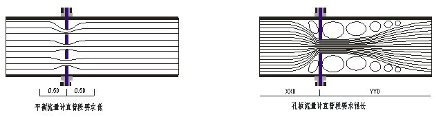

ƽºâÁ÷Á¿´«¸ÐÆ÷¾ßÓжԳƶà¿×½á¹¹Ìص㣬ÄܶÔÁ÷³¡½øÐÐÆ½ºâ£¬½µµÍÁËÎÐÁ÷¡¢Õñ¶¯ºÍÐźÅÔëÉù£¬Á÷³¡Îȶ¨ÐÔ´ó´óÌá¸ß£¬Ê¹ÏßÐԶȱȿװåÌáÉýÁË5¡«10±¶£¬Öظ´ÐÔÌá¸ßÁË54£¥£¬Îª0.15£¥£¬´ÓÆä×ÛºÏÐÔÄÜÀ´¿´£¬Æ½ºâÁ÷Á¿¼ÆÊôÓڸߵµÁ÷Á¿¼ÆÐÐÁС£
5:1Á¿³Ì±Èʱ£¬ÏßÐԶȿɴï¡À0.3£¥£»
7:1Á¿³Ì±Èʱ£¬ÏßÐԶȿɴï¡À0.5£¥£»
10:1Á¿³Ì±Èʱ£¬ÏßÐԶȿɴï¡À1.0£¥
¶þ¡¢Ö±¹Ü¶ÎÒªÇóµÍ
ƽºâÁ÷Á¿´«¸ÐÆ÷ÓÉÓÚÁ÷³¡Îȶ¨£¬ÇÒѹÁ¦»Ö¸´±È¿×°å¿ìÁ½±¶£¬´ó´óËù¶ÌÁ˶ÔÖ±¹Ü¶ÎµÄÒªÇóÆäǰºóÖ±¹Ü¶ÎÒ»°ãΪǰ3Dºó1D£¬×îС¿ÉÒÔСÓÚ0.5D£¬´Ó¶øÊ¡È¥´óÁ¿Ö±¹Ü¶Î£¬ÓÈÆäÊÇÌØÊâ°º¹óµÄ²ÄÁϵĹܵÀ¡£
