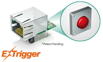

EXTrigger :
Ïë·½±ãµÄÅųýÍøÂçϵͳÖеĹÊÕÏÂð£¿Í¨¹ýMiiNePort E1µÄEXTriggerÒ»¼üʽ°´Å¥Á¢¼´ÖØÆôÍøÂçÉèÖá£

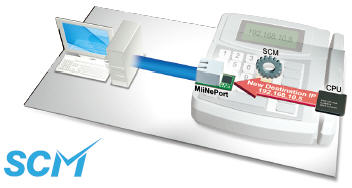

SCM£ºMiiNePort E1µÄ´®¿ÚÃüÁîģʽ£¨SCM£©Ê¹¸ÃÉ豸µÄÖ÷ϵͳÄܹ»ÖØÖÃÍøÂç²¢ÅäÖô®¿ÚºÍÒÔÌ«ÍøµÄÉèÖá£Õâͨ¹ý¼òµ¥µÄÃüÁî¿ò¼ÜÐÎʽ¼´¿ÉÍê³É£¬ÈκÎʱºò¾ù¿É¼ò±ãµØÅäÖÃÍøÂçÉèÖá£

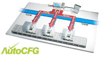

AutoCFG£ºMiiNePort E1Ö§³ÖAutoCFG£¬ÔÚ´ó¹æÄ£Éú²úÖпɱã½ÝµØÅäÖöàÉè±¸ÍøÂçÉèÖá£

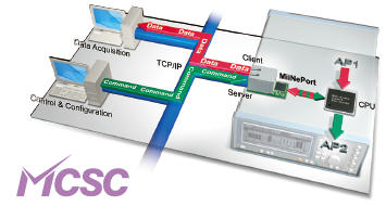

MCSC£ºÔÚÄ³Ð©ÌØÊâÇé¿öÏ£¬É豸×îÖÕÓû§ÐèÒªÉ豸ÄÜͬʱÔÚ·þÎñÆ÷ģʽºÍ¿Í»§¶ËģʽϹ¤×÷£¬Õâ¾ÍÒªÇóÄÚǶʽÉ豸ģ¿éÖ§³Ö¶àͨµÀͨѶ¡£MiiNePort E1µÄ¶àͨµÀ´®¿ÚͨÐÅ£¨MCSC£©¹¦ÄÜʹÓÃÒ»¸ö¾«ÇɵÄÈí¼þ½â¾ö·½°¸£¬ÎªÉ豸ÌṩÁ˶àͨµÀ¹¦ÄÜ¡£
