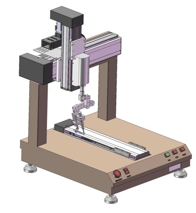

Òø¹â(VINKO)×Ô¶¯º¸Îý»úÆ÷ÈËÒÔCRVϵÁÐ×ÀÉÏÐͶ๦ÄÜ»úеÊÖΪ»ù´¡£¬·ÖΪÈýÖá×Ô¶¯º¸Îý»úÆ÷È˺ÍËÄÖẸÎý»úÆ÷ÈË¡£²úƷϵÁаüº¬¾­¼ÃÐͺ;«ÃܸßËÙÐÍ£¬¿Í»§¿ÉÒÔ¸ù¾Ýʵ¼ÊʹÓÃÒªÇó½øÐÐÑ¡Ôñ¡£

      CRV-300E3S  ×ÀÉÏÐÍÈýÖẸÎý»úÆ÷ÈË(¾­¼ÃÐÍ)
       XYZÈýÖẸÎý»úÆ÷ÈË£¨¾­¼ÃÐÍ£©²ÉÓò½½øµç»úºÍ¹öÖéÂݸËʽÇý¶¯£¬¼Û¸ñʵ»Ý£¬ÐԼ۱ȸߡ£
¡¡ ¹¦ÄÜ±í ¡¡
ÐͺÅModels
CRV-300E3S£¨¾­¼ÃÐÍ£©
¹¤×÷·¶Î§Working area(mm)
X  300  /  Y  300  /  Z  100
×î´ó¸ºÔØLoad(kg)
8 kg
ÒÆ¶¯ËÙ¶È Speed X-Y-Z
X-Y-Z /125mm/sec
½âÎöÄÜÁ¦Resolution
0.01mm/pules
ÖØ¸´¾«¶ÈRepetitive Positioning Accuracy
+/-0.02mm/axis
¿ØÖÆ·½Ê½Control Mode
4ÖáÔ˶¯¿ØÖÆÆ÷ 4 axis robot controller
ÏÔʾ·½Ê½Program Display
ÊÖ³Öʽ½Ìµ¼Æ÷ Teach Pendant LCD
Âí´ïϵͳMotor System
ÈýÖá²½½øÂí´ï3/axis AC stepping  motors
´«¶¯·½Ê½ProgramDrive3axis
ÈýÖá¹öÖéË¿¸Ü´«¶¯ 3/axis Ballscrews
ÈëÁ¦µçÔ´Power Supply
AC220V¡À10%, 50Hz,400W
»·¾³Î¶ÈWorking Temperature
0-40¡ã
»·¾³Êª¶ÈWorking Relative Humidity
20-90% no condensation
ÍâÐͳߴçDimensions(WxDxHmm)
524¡Á600¡Á700 (mm)
±¾ÌåÖØÁ¿Robot Weight
30 kg
