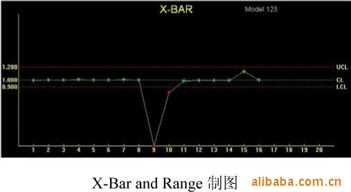

5£®X-Bar¹ÜÖÆÍ¼£¬Range¹ÜÖÆÍ¼£»

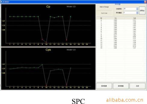

6£®Cp£¬Cpk¹ÜÖÆÍ¼¼°Í³¼Æ±¨±í¡£

X-Bar, Range, Cp, Cpk

ÕâÊÇÒ»¸ö»ùÓÚ¼ì²éºÍ²âÁ¿µÄ¹¤¾ß¡£Ëüͨ¹ýX,YºÍZÖá½øÐвâÁ¿£¬Í¨¹ýZÖá²âÁ¿µÄÊý¾Ý½«ÊµÊ±Í³¼Æµ½SPC½á¹ûÖС£ËüÔÊÐíµ¼³öÊý¾Ý(Îı¾»òExcel¸ñʽ)ºÍͼƬ¡£Óû§¿ÉÒÔ×ÔÐÐÉèÖÃÈÎÒâ²úÆ·ÀàÐ͵ÄSPC¼«ÏÞ¡£Í¨¹ý¶Ô²úÆ·½øÐвâÁ¿, ËùµÃ½á¹ûÓë¶ÔÓ¦²úÆ·ÀàÐ͵ÄSPC¼«ÏޱȽÏ, ¸ø³ö' Pass'(ͨ¹ý) »ò‘Fail'£¨Ê§°Ü£© ½á¹û¡£³ý±ê×¼µÄX,YºÍZ²âÁ¿ÈÝÒ×ÕÆÎÕÍâ,»¹Ìṩ¼¸ºÎ²âÁ¿¹¦ÄÜ,ËüÄÜʹֱ¾¶ºÍ½Ç¶È²âÁ¿¸ü¿ì,¸üÈÝÒ×
