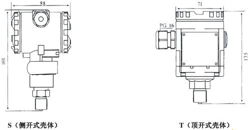

Èý¡¢µçÆøÁ¬½Ó¡¢ÍâÐμ°°²×°³ß´ç
1.        µçÆøÁ¬½ÓͼÏê¼û˵Ã÷Êé
2.      °²×°³ß´çͼ
