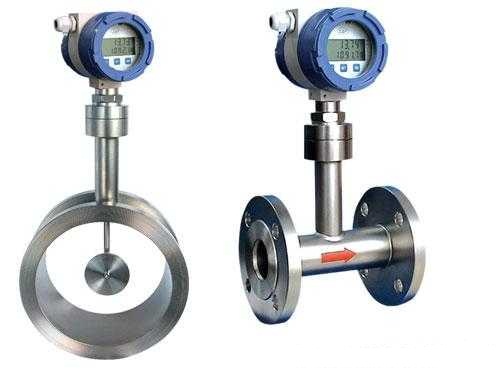

LBSϵÁаÐʽÖÇÄÜÁ÷Á¿¼Æ²ÉÓÃÁ˵çÈÝʽÁ¦´«¸ÐÆ÷×÷Ϊ²âÁ¿´«µÝÔª¼þ£¬Ó¦ÓÃÁË×îÐÂÊý×Ö¼¼ÊõºÍ΢µç×Ó¼¼Êõ£¬ÊÇÒ»¿îÊÊÓÃÓÚ¸ßÕ³¶È¡¢µÍÀ×ŵÊý¼°º¬ÓÐ΢С¿ÅÁ£µÄÒºÌåºÍÆøÌå²âÁ¿µÄÖÇÄÜÁ÷Á¿¼Æ£¬¶ø²ÉÓõĵçÈÝʽÁ¦´«¸ÐÆ÷ÊǸòúÆ·ÕæÕýʵÏָ߾«¶È¡¢¸ßÎȶ¨ÐԵĹؼüËùÔÚ¡£
RD-LBSϵÁаÐʽÖÇÄÜÁ÷Á¿¼Æ¼È¾ßÓд«Í³¿×°å¡¢ÎнֵÈÁ÷Á¿¼ÆÎ޿ɶ¯²¿¼þµÄÌØµã£¬Í¬Ê±ÓÖ¾ßÓÐÓëÈÝ»ýʽÁ÷Á¿¼ÆÏàæÇÃÀµÄ²âÁ¿×¼È·¶È£¬¼ÓÖ®ÆäÌØÓеĿ¹¸ÉÈÅ¡¢¿¹ÔÓÖÊÐÔÄÜ£¬³ýÄÜÌæ´ú³£¹æÁ÷Á¿¼Æ¼°³£¹æÁ÷ÌåÁ÷Á¿²âÁ¿Í⣬ÓÈÆäÔÚ¸ßÕ³¶È¡¢Ò׶¿¨¡¢¸ßΡ¢¸ßѹ¡¢Ç¿¸¯Ê´µÈÁ÷Á¿¼ÆÁ¿À§ÄѵŤ¿öÖоßÓкܺõÄÓ¦ÓüÛÖµ£¬Ä¿Ç°Òѹ㷺ӦÓÃÓÚ¸ÖÌú¡¢Ê¯ÓÍ¡¢ÌìÈ»Æø¡¢µçÁ¦¡¢ÔìÖ½¡¢»¯¹¤¡¢ÄÜÔ´¡¢Ê³Æ·¡¢»·±£µÈ¸÷¸öÁìÓòµÄÁ÷Á¿²âÁ¿¡£
²úÆ·ÌØµã£º
1.Î޿ɶ¯²¿¼þ£¬ÃÜ·âÃæ¼õÉÙ£¬´ó´ó½µµÍй©ÂÊ£¬±ãÓÚ°²×°ºÍÈÕ³£Î¬»¤¡£
2.²âÁ¿·¶Î§¿í£¬×î´ó²âÁ¿·¶Î§¿É´ï20:1(ÒºÌå)»ò10:1(ÆøÌå)¡£
3.¼ÆÁ¿×¼È·¡¢¾«¶È¸ß£¬·¨À¼Ê½¿É´ï0.2%(ÒºÌå)»ò0.5%(ÆøÌå)¡£
4.ÁéÃô¶È¼«¸ß£¬ÄܲâÁ¿³¬Ð¡Á÷Á¿£¬Æä¿É²âÁ¿µÍÁ÷ËÙΪ0.08m/s£¬µç´ÅÁ÷Á¿¼Æ0.5m/s¡£
5.ÖØ¸´ÐԺã¬Ò»°ãΪ0.05¡«0.08%,¾ßÓпÉѡСÐźÅÇгý£¬·ÇÏßÐÔÐÞÕý£¬Â˲¨Ê±¼ä¿ÉÑ¡Ôñ¡£
6.ѹÁ¦ËðʧС£¬Ð¡¿Ú¾¶½öΪ±ê×¼¿×°å1/2¡÷P×óÓÒ,DN100¿Ú¾¶ÒÔÉÏѹÁ¦Ëðʧ¿ªÊ¼´ó·ù¶È¼õÉÙ¡£
7.±ê¶¨·½±ã£¬³ý¿É²ÉÓñê×¼×°Öü춨Í⣬»¹¿É²ÉÓøÉʽ±ê¶¨·½·¨£¬¼´²ÉÓÃíÀÂë¹ÒÖØ·¨£¬µ¥¼ü²Ù×÷¼´¿ÉÍê³É±ê¶¨¡£
8.¿É¸ù¾Ýʵ¼ÊÐèÒª¸ü»»×èÁ÷¼þ¶ø¸Ä±äÁ÷Á¿·¶Î§£¬ÔÚÏ߿ɲð×°²åÈëʽ½á¹¹¿ÉʵÏÖ²»Í£²ú£¬²»¶ÏÁ÷άÐÞ»ò¸ü»»¡£
9.µÍ¹¦ºÄµç³ØÏÖ³¡ÏÔʾ£¬ÄÜÔÚÏßÖ±¶Áʾֵ£¬ÏÔʾÆÁ¿Éͬʱ¶Áȡ˲ʱÁ÷Á¿ÀÛ»ýÁ÷Á¿¼°°Ù·Ö±È°ôͼ£¬²¢¿ÉÇл»ÏÔʾ²¹³¥Î¶ȼ°²¹³¥Ñ¹Á¦Ê¾Öµ¡£
10.¿¹¸ÉÈÅ¡¢¿¹ÔÓÖÊÄÜÁ¦ÌØÇ¿£¬¶àÖÖÊä³öÐÎʽ£¬ÄÜÔ¶´«¸÷ÖÖ²ÎÊý£¬Ê¹ÓÃÎÞÐè°èÈÈ¡£
