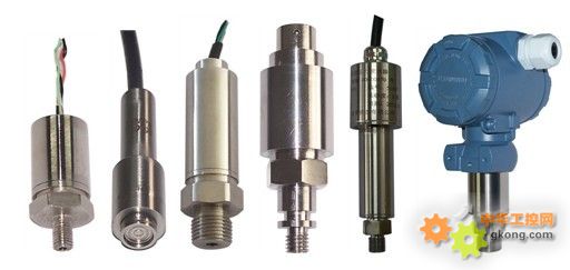

       ³¬µÍÎÂѹÁ¦´«¸ÐÆ÷£¬³¬µÍÎÂѹÁ¦±äËÍÆ÷²ÉÓò»Ðâ¸ÖÒ»Ì廯·â×°½á¹¹£¬¸ÐѹĤƬ²ÉÓÃÓÅÁ¼µÄÌØÊâÉè¼Æ£¬Ê¹´«¸ÐÆ÷ÔÚ³¬µÍÎÂ-196¡æ»·¾³Ï°²È«Îȶ¨¹¤×÷£¬Ìå»ýСÇÉ£¬²âÁ¿¾«¶È¸ß£¬¶¯Ì¬ÏìӦƵÂʸߣ¬¿¹¸¯Ê´ÄÜÁ¦Ç¿£¬¹¤×÷ÊÙÃü³¤¡£ÎÒÃǵÄרҵ¼¼ÊõÍÅÌåΪÄúÌṩ¶¨ÖÆ·þÎñ¡£
¸Ã²úÆ·Ö÷ÒªÓÃÓÚ£º
      µÍοÆÑ§ÊµÑ顢Һ̬Ñõ¡¢ÒºÌ¬µª¡¢ÒºÌ¬Ç⡢Һ̬º¤µÈ
      ÀäÈ´¹Þ¡¢µÍδ¢¹Þ¡¢Íƽø¼ÁµÈµÄѹÁ¦µÍβâÁ¿
      º½Ìì¡¢º½¿Õ¡¢½¢Í§µÈµÄµÍδ¢¹ÞµÈ
ÐÔÄܲÎÊý£º
±»²â½éÖÊ£º¶Ô17-4PH¡¢15-5PH¡¢316L²»Ðâ¸Ö²»¸¯Ê´µÄÆøÌåºÍÒºÌå
ѹÁ¦ÀàÐÍ£º¾ø¶ÔѹÁ¦¡¢Í¨Æø±íѹÁ¦¡¢ÃÜ·â²Î¿¼±íѹÁ¦¡¢²îѹ£¨¶¨×ö£©
Á¿³Ì£º0¡«0.2MPa¡­15MPa¡­60MPa Ö®¼äÈÎÒⷶΧ¿ÉÑ¡
¹©µçµçÔ´£º5-15VDCÍÆ¼ö£¨10VDC£©
ÁãµãÊä³ö£º¡À5% FS £¨µäÐÍÖµ£©
ÂúÁ¿³ÌÊä³ö£º10mV ¡¢20mV¡¢100mVÈýÖÖÊä³ö¿ÉÑ¡Ôñ £¨µäÐÍÖµ£©
ÍâÖñäËÍÆ÷£º¹©µç£º24VDC£¨¡À15VDC£©£¬Êä³ö£º0-5VDC¡¢4-20mA¿ÉÑ¡
·ÇÏßÐÔ£º0.1%FS¡¢0.2%FS
ÖØ¸´ÐÔ£º0.05%FS
׼ȷ¶È£º³£Î£º0.1%FS¡¢0.2%FS¡¢0.5% FS£»µÍΣº0.5%FS%¡«3%FS
¹¤×÷ζȣº-196¡æ¡«+125¡æ¡¢-260¡æ£¨ÌØÖÆ£©
ÈÈÁãµãÎÂÆ¯£º1¡«4%FS£¨È«ÎÂÇø£©
ÈÈÂúÁ¿³ÌÎÂÆ¯£º1¡«4.5%FS£¨È«ÎÂÇø£©
ÏìӦƵÂÊ£º£¾1kHz»ò£¾5kHz¿ÉÑ¡Ôñ
¾øÔµµç×裺¡Ý100 M¦¸/50V
°²È«¹ýÔØÑ¹Á¦£º150%FS £¨1.5±¶ÂúÁ¿³Ì£©
ÆÆ»µÑ¹Á¦£º300%FS £¨3±¶ÂúÁ¿³Ì£©
Õñ¶¯£º5¡«1000Hz£¬Õñ·ù2mm£¬X¡¢Y¡¢ZÿÏò30·ÖÖÓ£¬Êä³ö±ä»¯Ð¡ÓÚ0.1%FS
³å»÷£º50g£»X¡¢Y¡¢ZÈýÏò£¬Ã¿Ïò20ms£»Êä³ö±ä»¯Ð¡ÓÚ0.1%FS
Á¬½Ó·½Ê½£ºM3¡¢M4¡¢M5¡¢M6¡¢M8¡¢M10¡¢M12¡Á1»òÖ¸¶¨
½ÓÒº²ÄÁÏ£º15-5PH¡¢17-4PH¡¢316L²»Ðâ¸Ö
Ïà¶Ôʪ¶È£º95% RH
Íâ¿Ç·À»¤µÈ¼¶£ºIP65»òIP67
³öÏß·½Ê½£ºº½²å¡¢ÃÜ·âÖ±½ÓÒýÏß
ÐͺţºPPM-S312B¡­
    ÌØÊ⹤ÒÕ´¦Àí£¬Î¢Ð¡Ðͽṹ£¬mV¼¶Êä³ö£¬ÕûÌå¿ÉÔÚ-196¡æ»·¾³Ï¹¤×÷¡£ÐÔÄÜÎȶ¨£¬ÊÙÃü³¤¡£ÅäÍâÖñäËÍÆ÷Êä³ö4-20mAµçÁ÷»ò0-5VDCµçѹÐźš£
ÐͺţºPPM-S316B¡­
    ÌØÊ⹤ÒÕ´¦Àí£¬mV¼¶Êä³ö£¬ÔÚ-196¡æ»·¾³ÏÂÎȶ¨¹¤×÷£»¾«¶È¸ß£¬ÊÙÃü³¤£¬¶àÖÖ°²×°ÂÝÎÆ¿ÉÑ¡Ôñ£»ÌØÊâÐÍ×î¸ß-250¡æ£¬ÅäÍâÖñäËÍÆ÷Êä³ö4-20mAµçÁ÷»ò0-5VDCµçѹÐźš£
ÐͺţºPPM-T330B¡­
    Ò»Ì廯½á¹¹£¬ÄÚÖ÷ŴóÆ÷£»²âÁ¿½éÖÊζȣº-196¡æ¡«150¡æ£¬¹¤×÷»·¾³Î¶ȣº-40¡«105¡æ£»2ÏßÖÆ4-20mAµçÁ÷»·»ò0-5VDCÊä³ö¡£
PPM-T750A¡­³¬µÍÎÂÕæ¿Õ¶È´«¸ÐÆ÷ £¬²îѹ´«¸ÐÆ÷
    ÌØÊâ¼¼Êõ£¬¿É²âÁ¿³¬µÍÕæ¿Õ£¬¿É²âÁ¿-196¡æ¡¢-255¡æµÄÕæ¿Õ¶È¡£¿ÉÑ¡ÔñÂÝÎÆ°²×°¡¢¿ìж·¨À¼¡¢Ö±¹Ü²åÈ뼸ÖÖ·½Ê½£»ÊʺϷ¶Î§0.018Pa¡«200Pa¡¢1Pa¡«1kPa¡¢10Pa¡«10kPa ¡¢100Pa¡«100kPa ¡¢1kPa¡«1PaµÄÕæ¿ÕѹÁ¦¡¢0-¡«100kPa¸ºÑ¹Ñ¹Á¦¡£
²îѹÐÍ
PPM-T332/¡­³¬µÍÎÂѹÁ¦´«¸ÐÆ÷£¨¹¤Òµ¿ÇÌåÐÍ£©
    ¹¤Òµ¿ÇÌå½á¹¹£¬´«¸ÐÆ÷̽ͷÄ͵ÍΣ¬×ª»»µç·Ö÷ÅÔÚ·À»¤¿ÇÌåÄÚ£¬¾ßÓкܺõķÀ»¤¹¦ÄÜ£¬²âÁ¿½éÖÊζȣº-196¡æ¡«150¡æ¡¢-250¡æ¡«55¡æ£¬¹¤×÷»·¾³Î¶ȣº-40¡«105¡æ£»2ÏßÖÆ4-20mAµçÁ÷»·»ò0-5VDCÊä³ö¡£
PPM-SY03³¬µÍÎÂѹÁ¦´«¸ÐÆ÷£¨¸ßƵÏ죩
    ²ÉÓÃʯӢгÕñÔ­Àí£¬Ð¡ÇɵĽṹ£¬°²×°·½±ã£¬Äܹ»²âÁ¿-196¡æµÄÁ÷ÌåѹÁ¦£¬ÌصãÊÇÏìӦƵÂʿ죬¹ÌÓÐÆµÂÊÔ¼100kHz£¬ÊÇÔÚµÍλ·¾³ÏÂÒªÇó¸ßËÙ²âÁ¿Ñ¹Á¦±ä»¯µÄÀíÏë²úÆ·¡£
