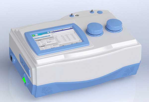

ÃèÊö£ºÆøÌåÖû»·¨ÊÇÒÔÆøÌåÈ¡´úÒºÌå²â¶¨ÑùÆ·ËùÅųöµÄÌå»ý.´Ë·¨ÅųýÁ˽þÒº·¨¶ÔÑùÆ·ÈܽâµÄ¿ÉÄÜÐÔ,¾ßÓв»Ëð»µÑùÆ·µÄÓŵã.£¬Ó¦ÓÃÆøÌåÇýÌæµÄ°¢»ùÃ×µÂÔ­Àí£¨Ãܶȣ½ÖÊÁ¿/Ìå»ý£©£¬ÀûÓÃС·Ö×ÓÖ±¾¶µÄ¶èÐÔÆøÌåÔÚÒ»¶¨Ìõ¼þϵIJ£¶û¶¨ÂÉ£¨PV=nRT£©
ÕæÊµÃܶȲⶨÒÇ TD-1200
²úÆ·Ãû³Æ£ºÕæÊµÃܶȲⶨÒÇ
²úÆ·ÐͺţºTD-1200
Éú²ú³§¼Ò£º±Ë°ÂµÂ
²úÆ·ÏêÇ飺
·ÖÎöÔ­Àí£º
ÆøÌåÖû»·¨ÊÇÒÔÆøÌåÈ¡´úÒºÌå²â¶¨ÑùÆ·ËùÅųöµÄÌå»ý.´Ë·¨ÅųýÁ˽þÒº·¨¶ÔÑùÆ·ÈܽâµÄ¿ÉÄÜÐÔ,¾ßÓв»Ëð»µÑùÆ·µÄÓŵã.£¬Ó¦ÓÃÆøÌåÇýÌæµÄ°¢»ùÃ×µÂÔ­Àí£¨Ãܶȣ½ÖÊÁ¿/Ìå»ý£©£¬ÀûÓÃС·Ö×ÓÖ±¾¶µÄ¶èÐÔÆøÌåÔÚÒ»¶¨Ìõ¼þϵIJ£¶û¶¨ÂÉ£¨PV=nRT£©£¬¾«È·²âÁ¿±»²â²ÄÁϵÄÕæÊµÌå»ý£¬´Ó¶øµÃµ½ÆäÕæ±ÈÖØ¡£
È«×Ô¶¯ÕæÊµÃܶȷÖÎöÒǼ¼Êõ²ÎÊý£º
·ÖÎö·½·¨£ºÆøÌåÖû»·¨
1.  ²â¶¨Ìå»ý·¶Î§£º0.01¡«25cm³
2.  ·ÖÎö²ÖÊýÁ¿£º 2¸ö
3.  ¾«È·¶È£ºÓÅÓÚ¡À0.06%
4.  ÖØ¸´ÐÔ£ºÓÅÓÚ¡À0.04%
5.  ÆøÂ·¿ØÖÆÏµÍ³£ºÁùλһÌåµç´Å·§¿ØÖÆÄ£¿é
6.  Èí¼þ¿ØÖÆÏµÍ³£ºINTERNETÔ¶³Ì¿ØÖÆ
7.  Êý¾Ý´æ´¢£ºÄÚÖòâÊÔÊý¾Ý´æ´¢Ä£¿é
8.  Êý¾Ý×ªÒÆ£ºUSB ½Ó¿Ú
9.  ÒÇÆ÷²Ù¿Ø£º10 Ó¢´ç¸ß·Ö±æÂÊÒº¾§´¥ÃþÆÁ
10. ·ÖÎöÆøÌ壺¸ß´¿º¤»ò¸ß´¿µª
11. ÑùÆ··ÖÎöʱ¼ä£º15·ÖÖÓ
12. ÒÇÆ÷Ìå»ý£ºL680 * W360 * H290 mm
13. ÒÇÆ÷ÖØÁ¿£º25 KG

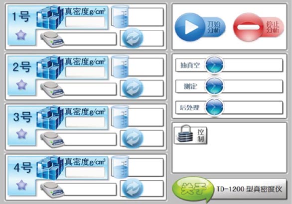

È«×Ô¶¯ÕæÊµÃܶȷÖÎöÒÇ¿ØÖÆÃæ°å½ØÍ¼
