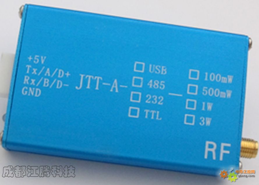

JTT-A-485΢¹¦ÂÊÎÞÏßÊý´«Ä£¿éÊdzɶ¼½­ÌڿƼ¼ÓÐÏÞ¹«Ë¾²ÉÓøßÐÔÄܵÄÎÞÏßÉ䯵IC, ÒÔ¼°¸ßËÙMCUÏà½áºÏ¿ª·¢³öµÄÒ»¿î¾ßÓÐǰÏò¾À´íÄÜÁ¦µÄ±ê×¼485½Ó¿ÚÎÞÏßͨÐÅÄ£¿é£¬Óû§²»ÐèÒª¶þ´Î¿ª·¢¼´¿É¼´²å¼´Óã»Óë±¾¹«Ë¾JTT-AϵÁС¢JTT-433-UDIµÈ»ùÓÚSI4432ÎÞÏßоƬµÄÄ£¿é¿ÉÖ±½ÓͨÐÅ£»Ä£¿éÌṩÁ˶à¸öƵµÀÑ¡Ôñ£¬¿ÉÔÚÏßÐ޸ĿÕÖÐËÙÂÊ£¬·¢É书Âʵȸ÷ÖÖ²ÎÊý¡£¸ÃÎÞÏßͨÐÅÄ£¿é²ÉÓÃÈ«ÂÁÍâ¿Ç£¬¾ßÓкÜÇ¿µÄ¿¹¸ÉÈÅÄÜÁ¦, ÁéÃô¶È¸ß£¬Ìå»ýС£¬Í¸Ã÷´«Êä, ¹¦ºÄµÍ£¬´«Êä¾àÀëÔ¶µÄÌØµã¡£ÒѾ­ÅúÁ¿ÓÃÓÚ°²·À¡¢µçÁ¦¼¯²ÙµÈ¶à¸öÁìÓò¡£

Ä£¿éÐÔÄܲÎÊý£º
¹¤×÷µçÔ´
DC5-7V
ÍâÐγߴç
68mm×43mm×19mm(²»º¬½ÓÏß×ùºÍÌìÏß×ù)
½Ó¿ÚÀàÐÍ
485
¹¤×÷ζÈ
-25-70¡æ
¹¤×÷ʪ¶È
10%¡«90%Ïà¶Ôʪ¶È,ÎÞÀäÄý
´«Êä¾àÀë
1700Ã×£¨¿ªÀ«µØ¿ÉÊÓ¾àÀë@1200bps£©
»º³åÇø´óС
256bytes
¹¤×÷ƵÂÊ
420-440MHz(1KHz²½½ø)
ƵµÀ¼ä¸ô
100KHz
ÐŵÀÊýÄ¿
>100
µ÷ÖÆ·½Ê½
GFSK
·¢É书ÂÊ
100mW(8¼¶¿Éµ÷,3dBm²½½ø)
½ÓÊÕÁéÃô¶È
-116dBm
Êý¾Ý¸ñʽ
8E1/8o1/8N1
¿ÕÖÐËÙÂÊ
1200/2400/4800/9600/19200/38400bps Óû§¿ÉÉ裨ÆäËüËÙÂʿɶ¨ÖÆ£©
´®¿ÚËÙÂÊ
»º³åÇø´óС
256Bytes
