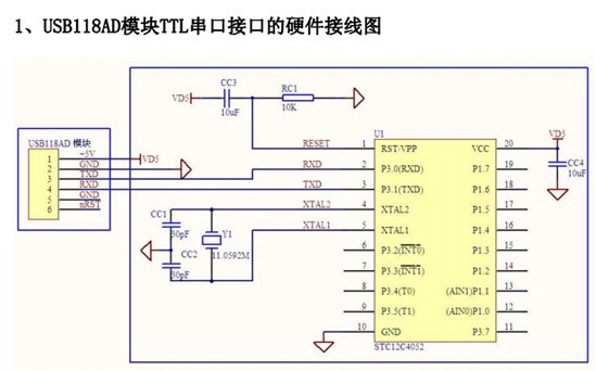

Ŀǰ£¬»ùÓÚUSB2.0½Ó¿ÚµÄÒÆ¶¯´æ´¢É豸ÒѾ­±»¹ã·ºµÄʹÓã¬USBÒÆ¶¯´æ´¢É豸±È½Ï³£¼ûµÄÈ磺UÅÌ£¬Òƶ¯Ó²Å̵ȵÈһЩ´óÈÝÁ¿Òƶ¯´æ´¢É豸¡£ÎÒÃǵÄUSB´æ´¢É豸£¬ÍùÍù×÷ΪslaveÉ豸ÓëhostÉ豸ÅäºÏʹÓá£Ò²ÐíÎÒÃǽӴ¥×î¶àµÄ¾ÍÊÇÓÃPC½øÐÐUÅ̵ĶÁд¹¦ÄÜ£¬Èç¹ûÎÒÃÇ×öʯÓÍ¡¢Ë®ÎÄ¡¢½»Í¨¡¢¹¤ÒµÏÖ³¡µÈ³¡ºÏµÄÊý¾Ý²É¼¯´æ´¢£¬ÍÑÀëµçÄÔ£¬ÎÒÃÇÄÜ·ñʹÓÃUSBÒÆ¶¯´æ´¢É豸À´´æ´¢º£Á¿µÄÐÅÏ¢£¿´ð°¸ÊÇÎãÓ¹ÖÃÒɵġ£
ǶÈëʽµç×Ó²úÆ·µÄ¹¦ÄܺÍÓ¦ÓÃÊDzúÆ·ÄÜ·ñÕù¶áÊг¡µÄ¾ö¶¨ÐÔÒòËØ£¬ÔÚÐÔÄÜÎȶ¨¿É¿¿µÄͬʱ£¬¿ª·¢ÖÜÆÚ¸üÊÇÊг¡ÍØÕ¹µÄÏÈ»ú¡£USB118ADÊÇÒ»¿î¿ÉǶÈëϵͳµÄСÐÍUSB¶Áдģ¿é£¬Í¨¹ýUSB118ADµÄÊ®ËÄÌõ¾«¼òÃüÁ²»ÓÃÁ˽âUSBͨÐÅЭÒ飬±ã¿ÉÒÔ·½±ãµÄΪǶÈëʽϵͳ¿ª·¢UÅÌ´æ´¢µÄÀ©Õ¹¡£
³ß´ç£º51.6*43*12mm
USB118ADÊǼ¯³ÉÁËARM7Êý¾Ý´¦ÀíÆ÷£¬Ö»ÐèǶÈëʽϵͳͨ¹ý×ÔÉíµÄ´®¿Ú£¨USATR£©¼òµ¥µÄ·¢ËÍÊ®ËÄÌõ¼ò¶ÌÖ¸Á±ã¿ÉÒÔ¶ÔUSBÒÆ¶¯É豸½øÐжÁÈ¡´æ´¢¹¦ÄÜ¡£ÆäÖд®¿Ú°üÀ¨Òì²½´®Ðнӿڣ¨UATR£©ºÍͬ²½´®Ðнӿڣ¨SPI£©¡£´æ´¢ËÙÂÊÂú×㲻ͬÐèÇó£¬RS232´®¿Ú²¨ÌØÂÊ£º9600\57600\115200¡£SPI½Ó¿Ú150k byte\sec¡£Ö§³ÖÎļþϵͳFAT16\FAT32£¬¿ÉÒÔ´´½¨word\excel\binµÈ¸÷ÖÖÀàÐÍÎļþ¡£
ÏÂÃæÒÔ51µ¥Æ¬»úAT89C51¾Ù¸öÀý×Ó£¬½øÐжÔUÅ̵ĽøÐнøÐмòµ¥µÄ¼ì²â²Ù×÷
MCS-51µ¥Æ¬»úCÓïÑÔʾÀý³ÌÐò £º
#include <REG51.h>
#include <stdio.h>
#define uchar unsigned char
#define uint unsigned int
//ÃüÁî(Ô¤ÉèÃüÁî)
uchar code Detect[66]={0xaa,0xbb,                0x01,0x20,0x20,0x20,0x20,0x20,0x20,0x20,0x20,0x20,0x20,0x20,0x20,0x20,0x20,0x20,0x20,0x20,0x20,0x20,0x20,0x20,0x20,0x20,0x20,0x20,0x20,0x20,0x20,0x20,0x20,0x20,0x20,0x20,0x20,0x20,0x20,0x20,0x20,0x20,0x20,0x20,0x20,0x20,0x20,0x20,0x20,0x20,0x20,0x20,0x20,0x20,0x20,0x20,0x20,0x20,0x20,0x20,0x20,0x20,0x20,0x20,0x20,0x20};
//¿ÉÒÔÌí¼ÓÆäËûÐèÒªÔöÌíµÄÃüÁԤÉèÃüÁ
Ö÷º¯ÊýÈë¿Ú
¹¦   ÄÜ£ºÊ¹·¢¹â¶þ¼«¹ÜÉÁ˸
Èë¿Ú²ÎÊý£ºÎÞ
³ö¿Ú²ÎÊý: ÎÞ
void main()
   SP = 0x60;                         //¶ÑÕ»Ö¸Õë
   Init_com();                     //³õʼ»¯´®¿Ú
    LED_blinking();                 //²âÊÔÓÃ
while(1)
       Send_Data(Detect);              //·¢Ëͼì²âUÅÌÖ¸Áî
      if(Receive_Data(0x04,0) == 1)   //04¼ì²âUÅÌÃüÁî´úÂ룬ÃüÁîÊÇ·ñ³É¹¦Ö´ÐУ¬ÊÇÔò¼ÌÐøÖ´ÐÐ
       delay_xms(200);
         break;
LEDÉÁ˸µÆ
Èë¿Ú²ÎÊý£ºÎÞ
³ö¿Ú²ÎÊý: ÎÞ
void LED_blinking(void)
    int a=0;
    while(a<4)
       P3_5 = ~P3_5;               //µ÷ÊÔָʾµÆ
       delay_xms(50);                  //ÑÓʱ0.2Ãë
       a++;
ÒÔÉÏÀý³ÌÊǶÔUÅ̵ļì²â³ÌÐò£¬¸ü¶à¼¼ÊõÐÅÏ¢Çë¹Ø×¢http://www.dataie.com
