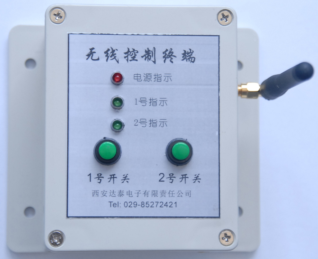

¢å ¶¨ÖƱ³¾°£º
ij×ÔÀ´Ë®³§µÄÒ»¸ö¿ØÖÆÊÒ£¬Í¨¹ý¿ØÖÆÖն˵İ´Å¥£¬ÎÞÏß¿ØÖÆ1500Ã×ÒÔÍâµÄÁ½Ì¨Ë®±ÃÆôÍ££¬²¢ÇÒ½«Ë®±ÃµÄ¹¤×÷״̬·´À¡µ½¿ØÖÆÊÒ¡£
¢æ ¼¼ÊõÒªÇó£º
¢Ù¿ØÖÆÊÒ¶Ë£ºDTD433MB_10£¨ÊýÁ¿£º1¿é£©
u     ¼¼ÊõÒªÇó£º
  • ÌṩÈý¸öָʾµÆ£ºLED1£¬LED2ºÍLED3
  • Button1µÄ¹¦ÄÜ£º¿ØÖÆ1ºÅË®±Ã£¬´øËø£»
  • Button2µÄ¹¦ÄÜ£º¿ØÖÆ2ºÅË®±Ã£¬´øËø.
  • LED1ΪµçԴָʾµÆ£»
  • LED2Ϊ1ºÅ±ÃµÄ¹¤×÷ָʾµÆ£¬°´ÏÂButton1£¬Èç¹û¿ØÖƳɹ¦£¬ÔòLED2³£ÁÁ£¬Èç¹û¿ØÖÆÊ§°Ü»òÕß²»¹¤×÷£¬ÔòLED2²»ÁÁ¡£
  • LED3Ϊ2ºÅ±ÃµÄ¹¤×÷ָʾµÆ£¬°´ÏÂButton2£¬Èç¹û¿ØÖƳɹ¦£¬ÔòLED3³£ÁÁ£¬Èç¹û¿ØÖÆÊ§°Ü»òÕß²»¹¤×÷£¬ÔòLED3²»ÁÁ¡£
u     ¼¼Êõ²ÎÊý£ºÊäÈëµçÔ´9¡«24VDC£¨×îСµçÁ÷1A£© £¬ÍâÐμ°°²×°³ß´ç£º129mm*116mm*69mm£¨L*W*H£©£¬PVC¿ÇÌå
¢ÚË®±Ã¶Ë£ºDTD433HB_10£¨ÊýÁ¿£º2¿é£©
u     ¼¼ÊõÒªÇó£º
Ë®±Ã¶ËDTD433HB_11Ìṩ1·¿ª¹ØÁ¿ÐźÅÊä³ö.
ÍâÐμ°°²×°³ß´ç£º115*74*60£¨L*W*H£©£¬PVC¿ÇÌ壬EÐ͵¼¹ì¿¨²Û
