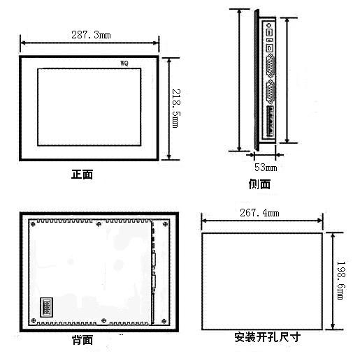

ÍâÐγߴç 287.3x218.5x53(mm)
°²×°¿ª¿×³ß´ç 267.4x198.6(mm)

²úÆ·Íâ¹Û¼°³ß´ç£¨µ¥Î»£ºmm£©
