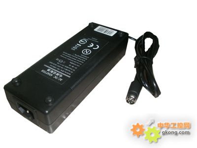

²úÆ·Ãû³Æ£º ´ó¹¦ÂÊÊÊÅäÆ÷
ÐÍ ºÅ£º YKD-120DC12V/24V 150DC12V
¹æ¸ñÊé
   ²úÆ·ÐͺţºYKD-120DC12V
²ÎÊý£º
1¡¢ÊäÈëµçѹ·¶Î§£¨ Input Voltage Range£©£º                              100Vac to 240Vac
2¡¢ÊäÈëÆµÂÊ£¨Input Frequency Range   £©                               47Hz to 63Hz
3¡¢ÊäÈëµçѹµÄг²¨Ê§ÕæInput Voltage Harmonic Distortion                     £ 8%
4¡¢Ð§ÂÊ£¨ÈÈÉíºó1Сʱ£©Efficiency (warm up after 1 hour)                     ³ 85%
5¡¢¿ÕÔØ¹¦ºÄNo Load Power Consumption           240Vac / 0A load            £1W
6¡¢Êä³ö¶î¶¨µçѹOutput Rated Voltage                                          12V
7¡¢Êä³öµçÁ÷Output Current                                                  0~12.5A
8¡¢Êä³öµçѹOutput Voltage Setting          µçÀÂÔÚÖ±Á÷Êä³ö¶Ëat the output end of DC cable                      11.4V~ 12.6V
9¡¢Êä³öµçÑ¹ÎÆ²¨Output Voltage Ripple                                          £200mVp-p
10¡¢Êª¶ÈHumidity                                                            ¹¤×÷ʪ¶È£º20% ~ 80%/´æÖüʪ¶È 10% ~ 90%
11¡¢ ζÈTemperature                                                          ¹¤×÷ζÈ0 to 40C/´æÖüζÈ-20 to +80C
12¡¢Æ½¾ùÎÞ¹ÊÕÏʱ¼äMTBF                                                                     100000 hours
13¡¢Turn-On Delay Timeµ¼Í¨ÑÓ³Ùʱ¼ä       at 100Vac/150W load, output voltage shall
remain regulationÔÚ100Vac/150W¸ºÔØ£¬Êä³öµçѹӦ±£³Öµ÷¿Ø                                    ¡Ü 2Sec
14¡¢Hold Up Time           at 100Vac or 240Vac / 150W load, output    voltage shall remain regulation    ¡Ý8 mS
±£³Öʱ¼ä                     ÔÚ100Vac»ò240V½»Á÷/ 150Í߸ºÔØ£¬Êä³öµçѹӦ±£³Öµ÷½Ú¡Ý8ºÁÃë
15¡¢ Rise Time               at 100Vac or 240Vac / 150W load, DCoutput rise time from 5% to 95% of Vo   ¡Ü 80mS
ÉÏÉýʱ¼ä                 ÔÚ100Vac»ò240V½»Á÷/ 150Í߸ºÔØ£¬DCoutputÉÏÉýʱ¼äÓÉ5£¥ÖÁ95£¥    ¡Ü80mS
16¡¢Load Transient Response     Output load step from ¡À50% change ofhalf load , S/R=0.5A/us, 100Hz &1KHz50% duty. Output voltage within spec.                                                                        11.4V~12.6V
17¡¢Over Current Protection  ¹ýµçÁ÷±£»¤
When an internal fault occurs, or an
external fault is applied to the adapter,
such that an overload or short circuit is
applied to the output, the adapter shall shut
down. It will enter into normal condition if
the fault condition is removed.
Shutdown and no damage.
µ±·¢ÉúÄÚ²¿¹ÊÕÏ£¬Íⲿ¹ÊÕÏ»òÓ¦Óõ½ÊÊÅäÆ÷£¬ÕâÑùÒ»¹ýÔØ»ò¶Ì·ӦÓõ½Êä³ö£¬¸ÃÊÊÅäÆ÷½«¹Ø±Õ¡£Èç¹û¹ÊÕÏÅųý¡£½«½øÈëÕý³£×´Ì¬£¬
18¡¢ Over-Voltage Protection¹ýµçѹ±£»¤
The adapter will enter into shut down that
means no output while over voltage
happened at output terminal that caused by
internal fault, the output trip voltage shall
not exceed 32 volts with a maximum
duration of 250 milliseconds. That will be
return to normal state by AC reset.
. ¸ÃÊÊÅäÆ÷½«³ÉΪ¹Ø±ÕÕâÒâζ×ÅûÓнøÈë¹ýµçѹ£¬¶øÊä³ö¶Ë£¬Í¨¹ýÄÚ²¿·¢Éú¹ÊÕÏËùÔì³ÉµÄÊä³ö£¬Êä³öµçѹ²»µÃ³¬¹ýÐгÌΪ250ºÁÃëµÄ×ÆÚÏÞ32·üÌØ¡£Õ⽫·µ»Ø½»Á÷reset.Shutdown²¢Ã»ÓÐË𺦵½Õý³£×´Ì¬¡£
19¡¢ Over Temperature Protection The adapter have thermal protection for
abnormal usage for/by parts failure. This
protection shall operate before rising to
reach to the cover-case¡¯s deformation and
discoloration temperature.
The adapter shall be shut down and enter
latch-off mode. That will be return to
No broken, no smoke
¹ýα£»¤µÄÊÊÅäÆ÷ÓÐ/Áã¼þ¹ÊÕÏÒ쳣ʹÓõÄÈÈ·À»¤¡£ÕâÖÖ±£»¤Ó¦ÉÏÉýµ½ÈÕǰÔË×÷´ïµ½¸ÇµÄ±äÐκͱäɫζÈÏÂÊÊÅäÆ÷½«±»¹Ø±Õ£¬½øÈë
±ÕËøÄ£Ê½¡£Õ⽫·µ»Øµ½Õý³£×´Ì¬½»Á÷¡£²»ÄÜײ»÷£¬²»ÄÜͶÈë»ðÖÐ
20¡¢³ß´ç£¨³¤x¿íx¸ß£©Dimension (Length x Width x Height)                                        172mm*65mm*37mm
21¡¢½»Á÷ÊäÈë²å×ùÀàÐÍInput AC socket Type                                                       ¹ú±êÆ·×ÖÐÎ
