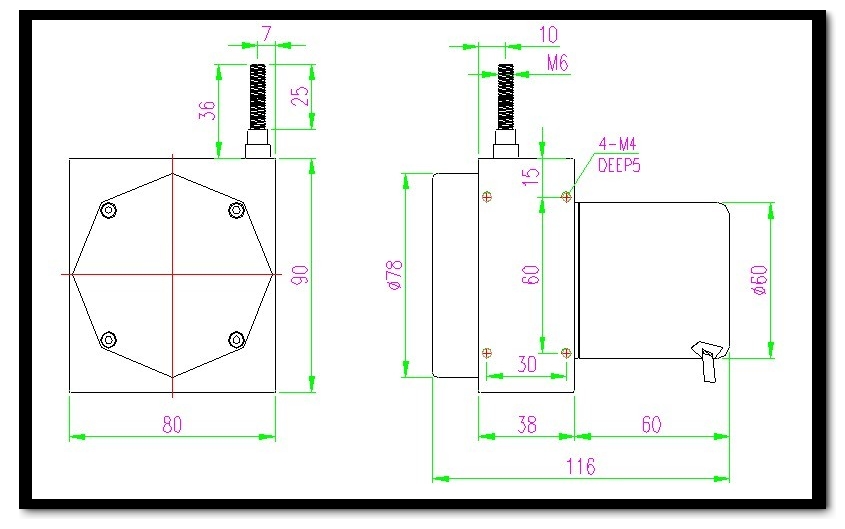

²úÆ·Ãû³Æ£º MPS-MÎ»ÒÆ´«¸ÐÆ÷
ÐÍ ºÅ£º MPS-M
Æ· ÅÆ£º 11049
MPS-M-£¨ºó׺£©ÏµÁÐÏêϸ½éÉÜ£º
1`Êä³öģʽ£¨ºó׺£©£ºRµç×èÐÍ¡¢VµçѹÐÍ¡¢AµçÁ÷ÐÍ¡¢P1ÔöÁ¿Âö³åÐÍ¡¢P2¾ø¶ÔÂö³åÐÍ
2`ÓÐЧÐг̣º1500¡«4000mm
3`ÏßÐÔ¾«¶È£º£¨R¡¢V¡¢AÐÍ£º0.3%¡«0.2%FS£©£¬£¨P1¡¢P2ÐÍ£º¡À1Âö³åFS£¬¿ÉÑ¡£©
4`ÖØ¸´¾«¶È£º£¨R¡¢V¡¢AÐÍ£º0.03%¡«0.02%FS£©£¬£¨P1¡¢P2ÐÍ£º¡À1Âö³åFS£¬¿ÉÑ¡£©
5`¹©µçµçѹ£ºRÐÍ£º¡«24VDC£»V¡¢AÐÍ£º24VDC£»P1¡¢P2ÐÍ£º5¡«24VDC£»
6`Êä³öÌØÕ÷£ºRÐÍ£º0¡«10K¦¸£»VÐÍ£º0¡«10VDC£»AÐÍ£º4¡«20Ma£»P1¡¢P2ÐÍ£º5VDCµçѹÐÍ£¬µçÁ÷ÐÍ£¬ÍÆÍìʽ£¬²î¶¯Ê½£»
7`³ÙÖÍ£ºR¡¢V¡¢AÐÍ£ºÎÞ£»P1¡¢P2ÐÍ£º10KHz¡«50KHz£»
8`×î´óÔÊÐíÀ­ÉìËÙ¶È£º1000mm/s£»
9`Ç£ÒýÁ¦£ºMax.900g
10`Õ𶯣º10g
11¡¢ÖØÁ¿£º1000G
12¡¢²úÆ·³ß´çͼ£º
