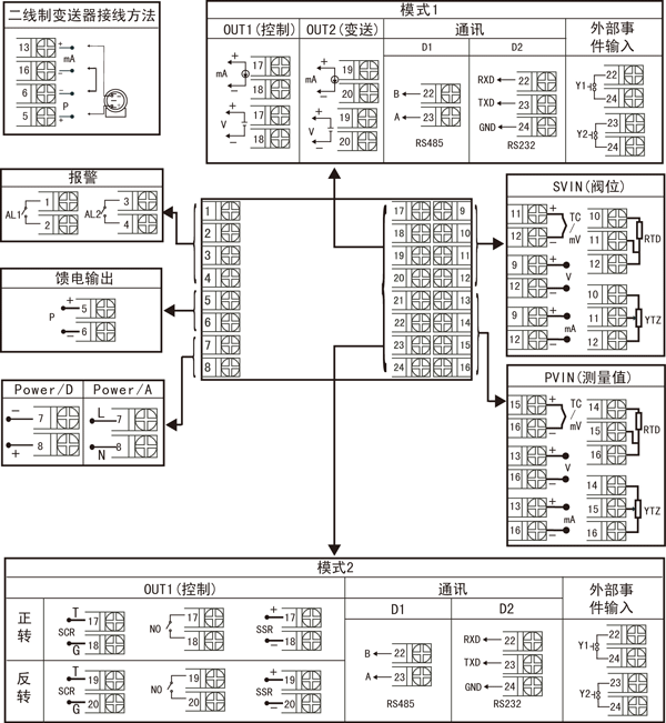

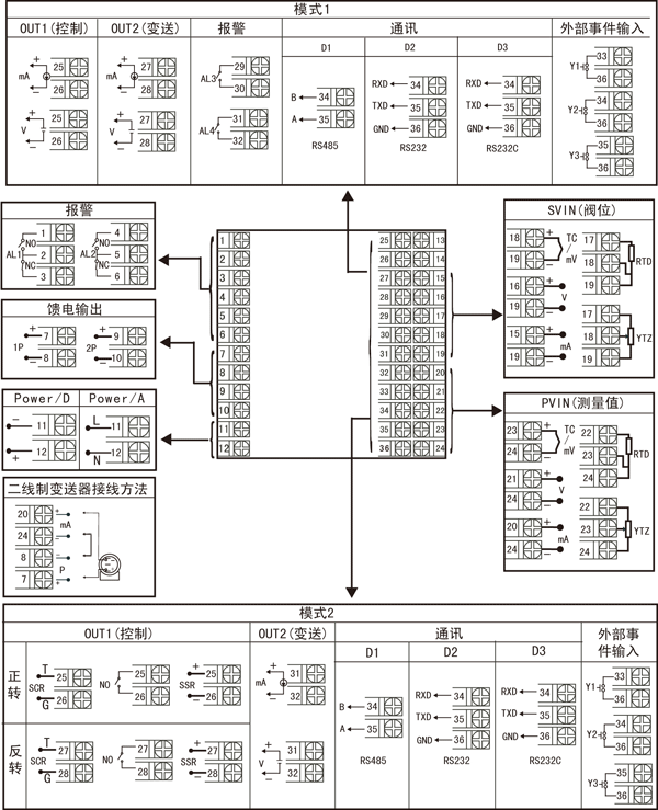

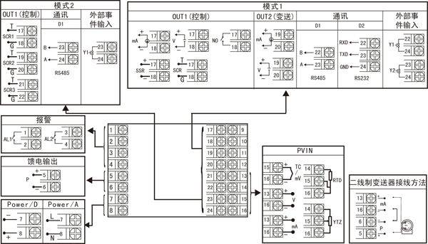

ÒDZí½ÓÏßͼ
NHR-5310µ¥Â·ÊäÈëPIDµ÷½ÚÆ÷½ÓÏßͼ
    ¹æ¸ñ³ß´çΪA¡¢B¡¢C¡¢D¡¢E¡¢K¡¢L¡¢MÐͽÓÏßͼ¡£
×¢£ººáÊúʽÒDZíºó¸Ç½ÓÏß¶Ë×Ó·½Ïò²»Ò»Ñù£¬¼ûʾÒâͼ1¡£
ͼһ

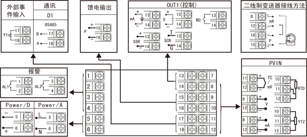

¹æ¸ñ³ß´çΪFÐͽÓÏßͼ
¹æ¸ñ³ß´çΪHÐͽÓÏßͼ
    ×¢£ºÉÏÊö½ÓÏßͼÖÐÔÚͬһ×é¶Ë×Ó±êÓв»Í¬¹¦Äܵģ¬Ö»ÄÜÑ¡ÔñÆäÖÐÒ»ÖÖ¹¦ÄÜ¡£ÈçRS485ºÍRS232ÔÚͬһ×é½ÓÏß¶Ë×ÓÉÏ£¬Ö»ÄÜÑ¡ÔñÒ»ÖÖ¡£

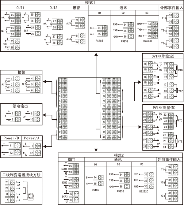

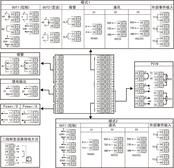

NHR-5320˫·ÊäÈ루Íâ¸ø¶¨£©PIDµ÷½ÚÆ÷½ÓÏßͼ
ͼһ
¹æ¸ñ³ß´çΪFÐͽÓÏßͼ

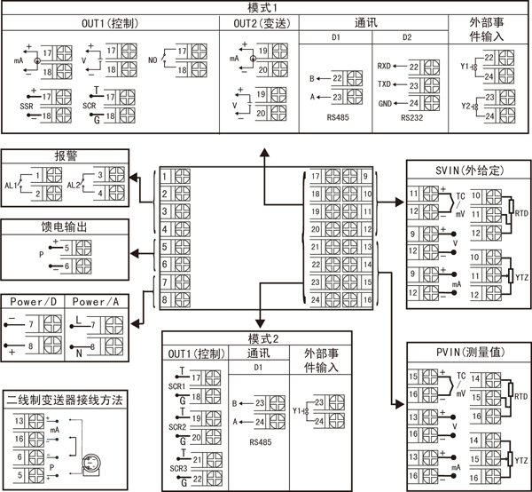

NHR-5330˫·ÊäÈ루·§Î»¿ØÖÆ£©PID¿ØÖÆÒǽÓÏßͼ
ͼһ
¹æ¸ñ³ß´çΪFÐͽÓÏßͼ
