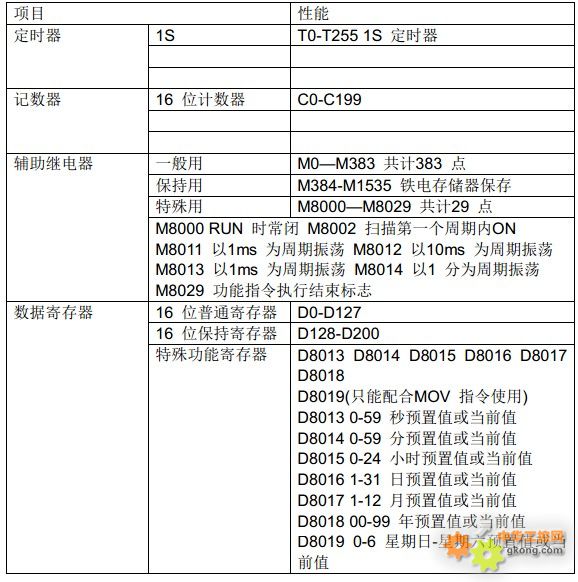

ÄÚ²¿¼ÌµçÆ÷×ܼÆÓÐ1536 µã£¬´øÓÐÌØÊ⹦Ä̵ܼçÆ÷ºÍ±£³ÖÓü̵çÆ÷¡£¶¨Ê±Æ÷256 µã¡£¼ÆÊýÆ÷200 µã¡£Êý¾Ý¼Ä´æÆ÷256 µã¡£

Îå¡¢»úÖÖ¹¹³ÉºÍ²úÆ·¹æ¸ñ

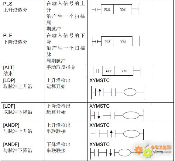

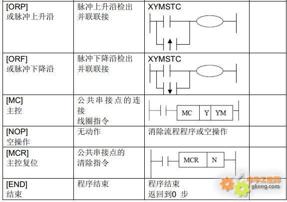

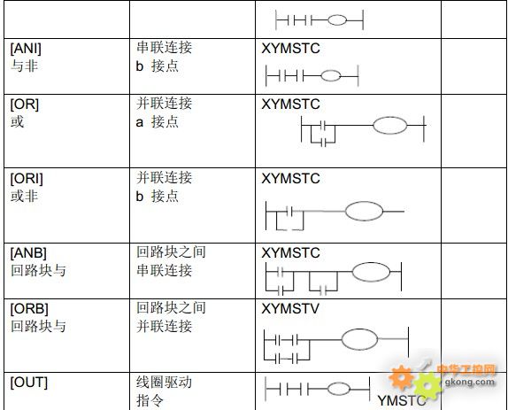

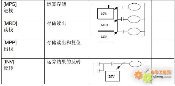

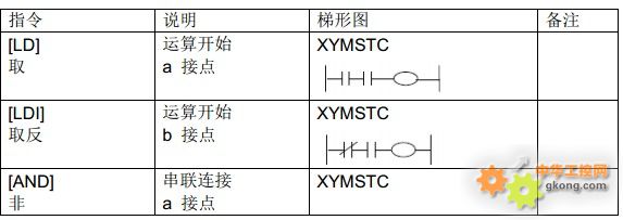

Áù¡¢JMDM-PLC12DI8DOMR»ù±¾Ö¸Áî˵Ã÷
