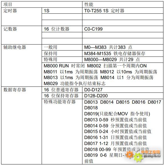

    (8)³ÌÐò¼Ä´æÆ÷´ï8000²½£»
ÄÚ²¿¼ÌµçÆ÷×ܼÆÓÐ1536µã£¬´øÓÐÌØÊ⹦Ä̵ܼçÆ÷ºÍ±£³ÖÓü̵硣¶¨Ê±Æ÷256µã¡£¼ÆÊýÆ÷200µã¡£Êý¾Ý¼Ä´æÆ÷256µã¡£±à³ÌÓïÑÔ²ÉÓÃÌÝÐÎͼ¡£²ÉÓÃÑ­»·É¨Ã蹤×÷·½Ê½¡£

ËÄ¡¢PLCÓ²¼þ×ÊÔ´
    (1)×ܼÆ×î¶à¿ÉÒÔ´ïµ½12µã£¬ÊäÈëÊä³öÅäÖÃÈçÏ£º
    ÊäÈëµã£º8µã X000¡ªX007£»Êä³öµã£º4µã Y000¡ªY003
Îå¡¢»úÖÖ¹¹³ÉºÍ²úÆ·¹æ¸ñ

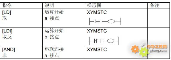

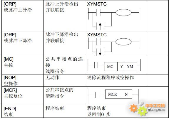

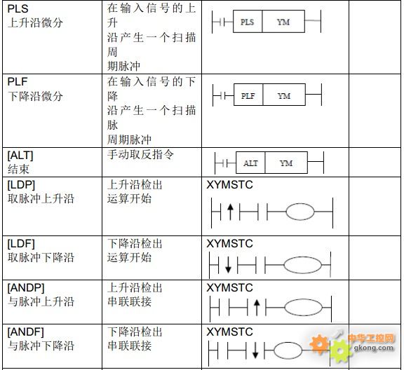

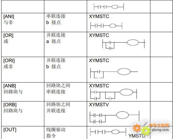

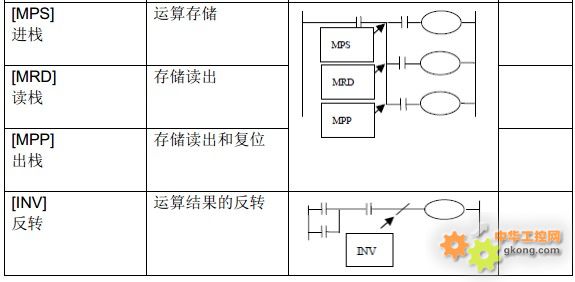

Áù¡¢JMDM-PLC8DI4DOMR»ù±¾Ö¸Áî˵Ã÷
