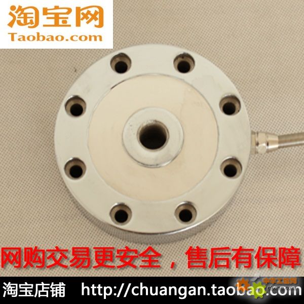

²úÆ·Ãû³Æ£º ÂÖ·ø³ÆÖØ´«¸ÐÆ÷ÂÖ·øÀ­Ñ¹Á¦´«¸ÐÆ÷
ÐÍ ºÅ£º DYLF
Æ· ÅÆ£º 11468

º£ÄÏÊ¡´«¸ÐÆ÷ Ì¨ÍåÊ¡´«¸ÐÆ÷ Ïã¸ÛÌØ±ðÐÐÕþÇø´«¸ÐÆ÷​  °ÄÃÅÌØ±ðÐÐÕþÇø´«¸ÐÆ÷​¸Ã´«¸ÐÆ÷²ÉÓÃÂÖ·øÊ½µ¯ÐÔÌåÀ­Ê½½á¹¹£¬¾ßÓеÍÍâÐΡ¢¿¹Æ«ÔØ¡¢¾«¶È¸ß¡¢Ç¿¶ÈºÃ¡¢°²×°·½±ã¡¢À­Ñ¹Êä³ö¶Ô³ÆÐԺõÈÌØµã¡£
¹ã·ºÓÃÓÚ¹¤ÒµÏµÍ³ÖÐÁ¦µÄ²âÁ¿ºÍÌì³µ³Æ¡¢¹ìµÀºâ¡¢Á϶·³ÆµÈ¸÷ÖÖ³ÆÖØ¡¢²âÁ¦µÄ¹¤Òµ×Ô¶¯»¯²âÁ¿¿ØÖÆÏµÍ³....
²ÎÊý
µ¥Î»
¼¼ÊõÖ¸±ê
²ÎÊý
µ¥Î»
¼¼ÊõÖ¸±ê
ÁéÃô¶È
mV/V
2.0±0.05
ÁéÃô¶ÈζÈϵÊý
≤%F·S/10¡æ
±0.03
·ÇÏßÐÔ
≤%F·S
±0.03
¹¤×÷ζȷ¶Î§
¡æ
-20¡æ¡«+80¡æ
Öͺó
≤%F·S
±0.03
ÊäÈëµç×è
Ω
750±20Ω
ÖØ¸´ÐÔ
≤%F·S
±0.03
Êä³öµç×è
Ω
700±5Ω
Èä±ä
≤%F·S/30min
±0.03
°²È«¹ýÔØ
≤%F·S
150% F·S
ÁãµãÊä³ö
≤%F·S
±1
¾øÔµµç×è
≥5000MΩ(50VDC)
ÁãµãζÈϵÊý
≤%F·S/10¡æ
±0.03
ÍÆ¼ö¼¤Àøµçѹ
V
10V-15V
8¿×ÂÖ·ø´«¸ÐÆ÷_05
ÌØµãÓëÓÃ;
    ¸Ã´«¸ÐÆ÷²ÉÓÃÂÖ·ùʽµ¯ÐÔÌåÀ­Ê½½á¹¹£¬¾ßÓеÍÍâÐΡ¢¿¹Æ«ÔØ¡¢¾«¶È¸ß¡¢Ç¿¶ÈºÃ¡¢°²×°·½±ã¡¢À­Ñ¹Êä³ö¶Ô³ÆÐԺõÈÌØµã¡£
   ¹ã·ºÓÃÓÚ¹¤ÒµÏµÍ³ÖÐÁ¦µÄ²âÁ¿ºÍÌì³µ³Ó¡¢¹ìµÀºâ¡¢Á϶·³ÓµÈ¸÷ÖÖ³ÆÖØ¡¢²âÁ¦µÄ¹¤Òµ×Ô¶¯»¯²âÁ¿¿ØÖÆÏµÍ³¡£
ÍâÐγߴçͼ
2012.8.4_15.38.10_7665
Á¿³Ì
ΦA
ΦB
ΦC
M
H
H1
H2
ΦD
ΦC
200-700kg
88
72
22
M12×1.75
34
31
7.2
8-Φ11
8-Φ7
2-5t
105
89
32
M16×1.5
37
34
7.2
8-Φ11
8-Φ7
10-20t
120.6
101.8
39
M32×1.5
53.5
41
10.5
8-Φ14
8-Φ9
30t
141
116.8
50.4
M40×1.5
57.2
50.8
11
8-Φ18
8-Φ11
Á¿³Ì
ΦA
ΦB
ΦC
M
H
H2
ΦD
ΦD1
40-60t
208
174
95
M64×3
70
15
16-Φ20
16-Φ13
80-100t
280
230
120
M76×3
90
20
16-Φ30
16-Φ17
