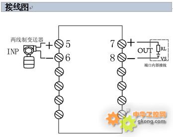

ÊäÈë¹æ¸ñ
´úÂë
ÊäÈëÐźÅ
Åäµçµçѹ
1
4¡ª20mAÁ½ÏßÖÆ±äËÍÆ÷
16-22V
Êä³ö¹æ¸ñ
´úÂë
Êä³öÐźÅ
1
Á½ÏßÖÆÊä³ö4¡ª20mA
ÌØ   µã
¡ñ Ò×Á¬½Ó£¬³¤ÊÙÃü
¡ñ ÊäÈ룬Êä³ö¼ä¸ôÀë
¡ñ ×Ô¹©µç£¬Êä³ö¶ËÈ¡µç
¡ñ ÍâÐÎСÇÉ£¬ºñ¶È½ö12.5mm
¡ñ DINµ¼¹ì°²×°£¬²å°Îʽ¶Ë×Ó
¼¼ÊõÖ¸±ê
Åäµçµçѹ£º16-22V£¨×î´óÇý¶¯µçÁ÷30mA£©
Êä³ö¸ºÔØ£º0¡ª500¦¸(¶Ë¿ÚÄÚ²¿µçÔ´24Vʱ)
ÏìӦʱ¼ä£º<0.05s£¨0~90%£©£¨TYP£©
²¨    ÎÆ£º<10mVrms
´«ÊäÎó²î£º0.2%µÄÖÕÖµ
ζÈϵÊý£º15ppm/KµÄ²âÁ¿Öµ/100¦¸¸ºÔØ
ÄÍѹǿ¶È£º2500VDCʱ100M¦¸ÒÔÉÏ£¬1500VAC/·ÖÖÓ
µç´Å¼æÈÝÐÔ£º·ûºÏGB/T18268¹¤ÒµÉ豸ӦÓÃÒªÇó
           £¨µÈͬIEC61326-1£©
¹¤×÷ζȣº-25¡æ~+85¡æ
¹¤×÷ʪ¶È£º<90%RH£¨ÎÞÄý½áË®£©
Íâ¿Ç²ÄÁÏ£ºABS×èȼ
ÖØ    Á¿£ºÔ¼70¿Ë
ÍâÐγߴ磺ºñ12.5¡Á¿í106¡Á¸ß112(mm)
Ñ¡Ð;ÙÀý
PA-02¡õ ¡õ        Àý£ºPA-0211
                  Êä³ö´úÂë:  1.  4¡ª20mA
                  ÊäÈë´úÂë:  1.  4¡ª20mA
