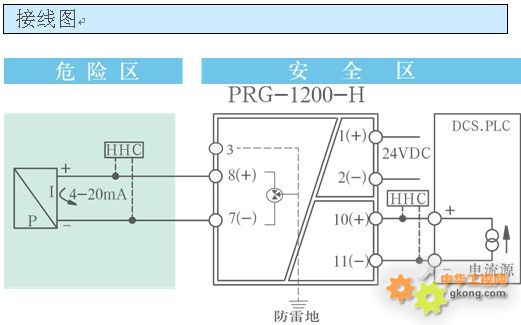

ÀËÓ¿±£»¤½ÓÏß×¢ÒâÊÂÏî
   1. ´øÀËÓ¿±£»¤Ê±£¬ÒDZí3½Å¶Ë×Ó±ØÐë½ÓµØÏߣ»
   2£®²ÉÓÿɲð·Ö½ÓÏß¶Ë×Ó£¬·½±ãʹÓã»
   3£®µ¼Ïß²ÉÓýØÃæ»ý0.5mm2¡«2.5 mm2£»
   4£®µ¼ÏßÂã¶³¤¶ÈÔ¼8mm£¬ÓÉM3Âݶ¤Ëø½ô

ÈÏÖ¤²ÎÊý£º¶Ë×Ó£¨7-8£©
Um = 250VAC/DC    Uo = 28VDC      Io = 93mA       Po = 0.65W         Lo = 2.4 mH      Co = 0.05¦ÌF
×¢£º1¡¢ÔÚΣÏÕÇøºÍ°²È«Çø²»ÄÜͬʱʹÓÃHHC(HARTÊÖ²ÙÆ÷)
      2¡¢ÔÚΣÏÕÇøÊ¹ÓõÄHHC(HARTÊÖ²ÙÆ÷)±ØÐë¾­¹ý    ·À±¬ÈÏÖ¤
