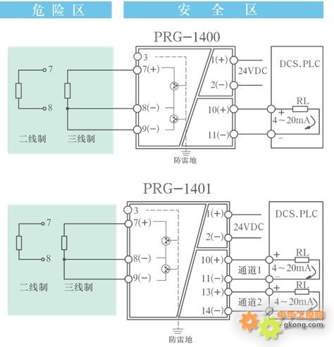

½ÓÏßͼ
×¢£º1.ÈýÏßÖÆµç×èÐźÅÊäÈëʱ£¬Òª¾¡¿ÉÄܱ£Ö¤Èý¸ùµ¼Ïßµç×èÖµÏàµÈ
      2.¶þÏßÖÆµç×èÐźÅÊäÈëʱ£¬¸ôÀëÕ¤¶Ë×Ó8.9±ØÐë¶Ì½Ó
