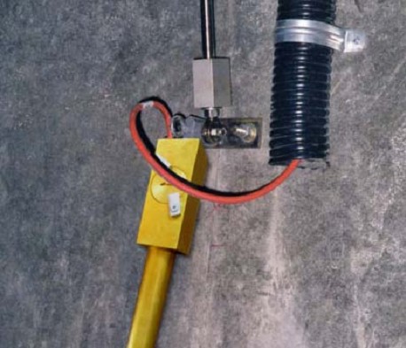

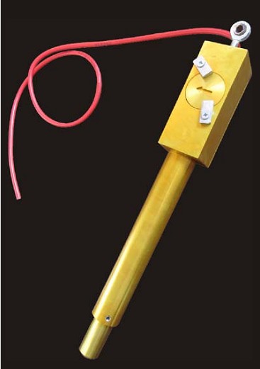

ËíµÀ¶ÏÃæÊÕÁ²ÏµÍ³Óɰ²×°ÔÚËíµÀÄÚ±ÚÉϵÄһϵÁÐÁ¬½Ó¸Ë×é³É£¬²¢Í¨¹ýÊý¾Ý²É¼¯Æ÷ºÍÊý¾Ý´¦ÀíÈí¼þʵʱµÃµ½ËíµÀµÄÇé¿öÇÒÄÜͨ¹ýͼÐνøÐÐÏÔʾ¡£

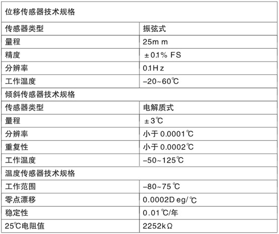

¡¡¡¡°²×°ÔÚËíµÀÄÚ±ÚÉϵÄÿ¸ù²â¸ËÓɸ߾«¶ÈµÄÎ»ÒÆ´«¸ÐÆ÷ºÍÇãб´«¸ÐÆ÷×é³É£¬ËíµÀ¶ÏÃæµÄÊÕÁ²±äÐÎʹµÃ´«¸ÐÆ÷²úÉú±ä룬Êý¾Ý²É¼¯ÏµÍ³×Ô¶¯¼Ç¼Êý¾Ý²¢´«Ë͵½¼ÆËã»ú£¬Êý¾Ý´¦ÀíÈí¼þ½øÐзÖÎö²¢ÊµÊ±ÏÔʾËíµÀµ±Ç°µÄÊÕÁ²±äÐÎÇé¿ö¡£

•ΪÁ˱ÜÈÃËíµÀÏÖ³¡ÆäËûÉ豸ϵͳ²â¸Ë¿ÉÒÔÖÆ×÷ÍäÇúÐÎ×´
•²»Ó°ÏìËíµÀ½»Í¨
•¸ßϵͳ¾«¶È
•¿É²ÉÓÿª¿Ú»ò±ÕºÏÐÎʽ
•ÄÚÉèζȴ«¸ÐÆ÷¿É½øÐÐϵͳζÈÐÞÕý
•²â¸Ë³¤¶È¿É¸ù¾ÝÏÖ³¡Ìõ¼þ¶¨ÖÆ
