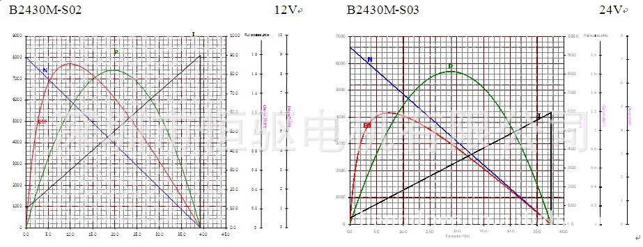

Characteristic: CW/CCW Both rotation, Signal function available, Locked rotor protection, Low inertia, Low noise, Low EMI, Long life over 10000hrs        特征:双转向信号功能,锁定保护,低惯量,,低噪音,低电磁干扰,超长寿命10000小时以上
Outline Drawing 外形图:
Usable machine screw length 2.0mm max. from motor mounting surface               Unit: Millimeter
Performance Curve性能曲线:
