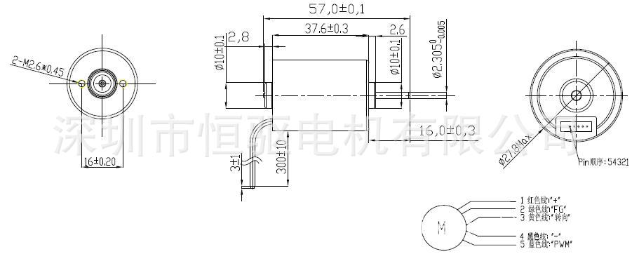

Outline Drawing ÍâÐÎͼ:
Usable machine screw length 2.0mm max. from motor mounting surface
Unit: Millimeter

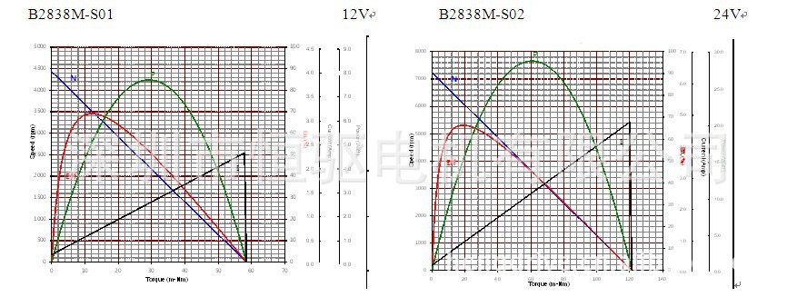

Performance Curve ÐÔÄÜÇúÏß:
