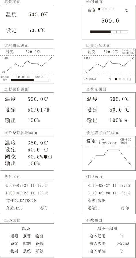

ÒDZíÃæ°å
160*80mm(AÐÍ) 80*160mm(BÐÍ) 96*96mm(CÐÍ)
¢ÙÏÔÊ¾Ãæ°å
¢ÚUSB¡¢SD½Ó¿Ú
¢ÛÈ·Èϼü
ÏÔʾͨµÀÇл»¼ü
ʱ±êÇл»¡¢ÊÖ/×Ô¶¯Çл»¼ü
¢Ü¹â±êÓÒÒÆ¼ü
¢Ý¹â±ê×óÒÆ¼ü
¢Þ¹â±êÉÏÒÆ¼ü
¢ß¹â±êÏÂÒÆ¼ü
¼òÒ×»­ÃæÖ¸Ê¾

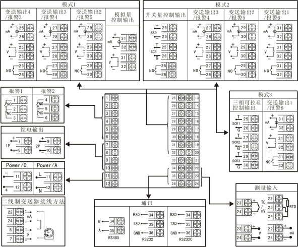

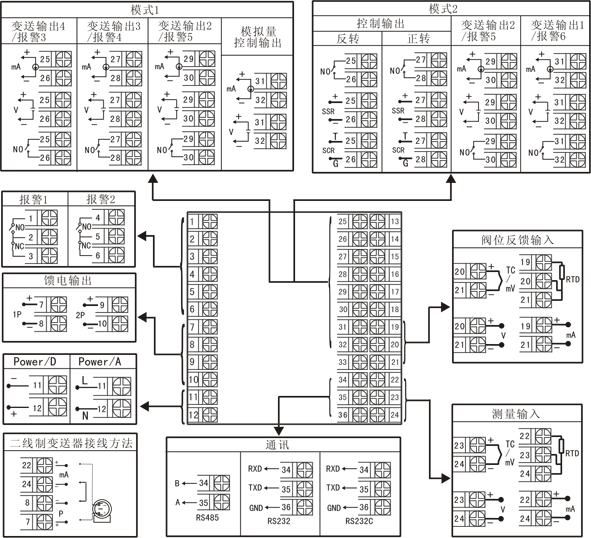

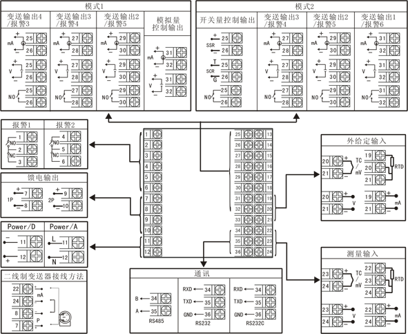

½ÓÏßͼ
NHR-7310(R)/7340(R)ϵÁÐÒDZí½ÓÏßͼ
NHR-7320(R)ϵÁÐÒDZí½ÓÏßͼ
NHR-7330(R)ϵÁÐÒDZí½ÓÏßͼ
    ×¢1£º½ÓÏßͼÖÐÔÚͬһ×é¶Ë×Ó±êÓв»Í¬¹¦Äܵģ¬Ö»ÄÜÑ¡ÔñÆäÖÐÒ»ÖÖ¹¦ÄÜ¡£ÈçRS485ºÍRS232ÔÚͬһ×é½ÓÏß¶Ë×ÓÉÏ£¬Ö»ÄÜÑ¡ÔñÒ»ÖÖ¡£
    ×¢2£ººáÊúʽÒDZíºó¸Ç½ÓÏß¶Ë×ӵķ½Ïò²»Ò»Ñù£¬¼ûʾÒâͼ1
