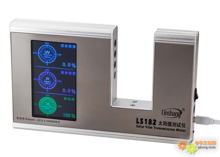

     LS182Ì«ÑôĤ²âÊÔÒǵIJâÊÔÔ­ÀíÊDzÉÓÃ×ÏÍâ¹âÔ´£¬¿É¼û¹âÔ´ºÍºìÍâ¹âÔ´ÕÕÉä±»²â͸Ã÷ÎïÖÊ£¬¸ÐÓ¦Æ÷·Ö±ð̽²â¹âÔ´µÄÈëÉä¹âÇ¿ºÍ͸¹ý±»²â͸Ã÷ÎïÖʺóµÄ¹âÇ¿£¬Í¸¹ý¹âÇ¿ÓëÈëÉä¹âÇ¿µÄ±ÈÖµ¼´ÎªÍ¸¹ýÂÊ£¬ÓðٷÖÊý±íʾ¡£
´ó¶àÊýµÄÌ«ÑôĤ£¬¿É¼û¹â±êע͸¹ýÂÊÖ¸±ê£¬ºìÍâÏߺÍ×ÏÍâÏß±ê×¢×è¸ôÂÊÖ¸±ê£¬×è¸ôÂÊ=100%-͸¹ýÂÊ¡£LS182Ö±½Ó²âÁ¿ºÍÏÔʾ×ÏÍâÏßµÄ×è¸ôÂÊ£¬ºìÍâÏßµÄ×è¸ôÂʺͿɼû¹â͸¹ýÂÊ£¬·½±ã¶ÁÊýºÍÀí½â¡£

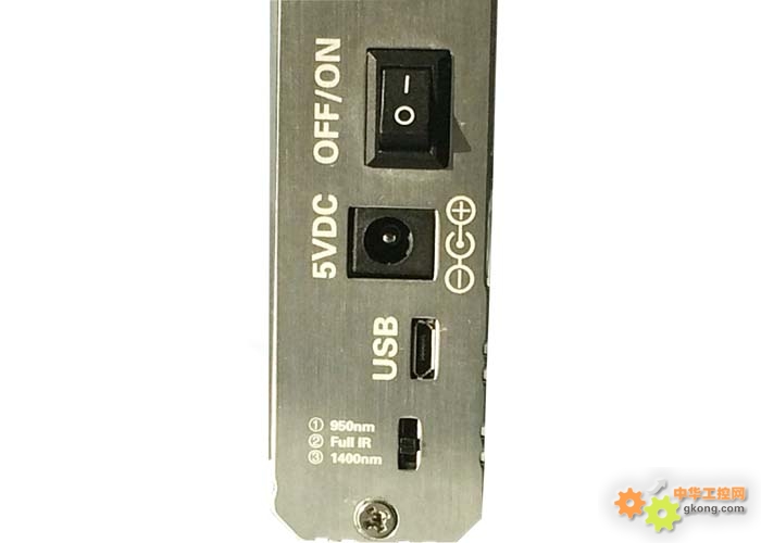

     ÓÒͼΪÒÇÆ÷µÄ²à±ß´ò±êÎÄ×Ö¡£
?    “OFF/ON” ΪÒÇÆ÷¿ª¹Ø
?    “5VDC” ΪAC/DCµçÔ´²å¿Ú
?    “USB” Ϊһ¸öMicro USB×ù£¬·½±ãÒÆ¶¯µçÔ´¸øÒÇÆ÷¹©µç

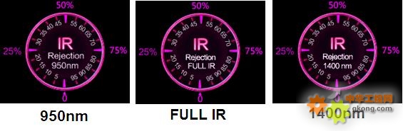

?    “950nm£¬Full IRºÍ1400nm”,²¦Â뿪¹ØÑ¡ÔñÈýÖÖ²»Í¬µÄºìÍâ²âÊÔ²¨¶Î

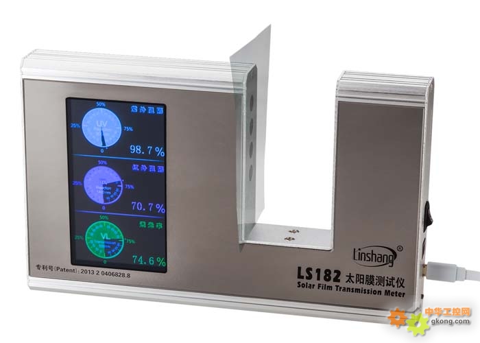

2£º½«±»²âÊÔÎ̫ÑôĤ£¬ÌùĤµÄ²£Á§µÈ£©·ÅÈë²âÊÔ²ÛÄÚ¡£Á¢¼´ÏÔʾ±»²âÎï¶Ô×ÏÍâÏß×è¸ôÂÊ£¬ºìÍâÏß×è¸ôÂʺͿɼû¹âµÄ͸¹ýÂÊ¡£ºìÍâÏßµÄ×è¸ôÂÊΪ²¦Â뿪¹ØÑ¡Ôñ¶ÔÓ¦²¨¶Î£¨950nm£¬Full IRºÍ1400nm£©µÄ×è¸ôÂÊ£¬ºìÍâÏÔʾָÕë±íÖмäÒ²±êÃ÷Á˶ÔÓ¦µÄ²¨¶Î¡£
 ÈçÏÂͼËùʾ£ºÑùÆ·Ì«ÑôĤµÄ×ÏÍâÏß×è¸ôÂÊΪ98.7%£¬ºìÍâÏß×è¸ôÂÊΪ70.7%£¬¿É¼û¹â͸¹ýÂÊΪ74.6%¡£
