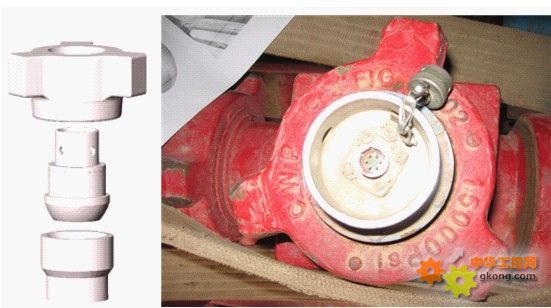

        PT124B-2521ʯÓ͹̾®|Ëữ|ѹÁÑ|ѹÁѳµÑ¹Á¦´«¸ÐÆ÷/±äËÍÆ÷,Ñ¡ÓÃÓÅÖʽø¿Úµ¯ÐÔÌå¼°¸ß¾«¶È¸ÐѹоÌ壬²ÉÓò»Ðâ¸ÖÕûÌå·â×°£¬·À³±ÃÜ·âÐԺ㬳ö³§¾­¹ýÊýǧ´ÎÆ£Àͳå»÷ÊÔÑ飬¾ßÓж¯Ì¬·´Ó¦¿ì¡¢¾«¶È¸ß¡¢¿¹Õñ¶¯¡¢¿¹Æ£ÀÍ¡¢¿¹Æ«ÔØÄÜÁ¦Ç¿¡¢½á¹¹¼á¹Ì¡¢Ä͸¯Ê´µÈÌØµã£»±äËÍÆ÷ÄÚÖÿ¹¸ÉÈÅ·Å´óµç·£¬Êʺϸ´ÔÓÌõ¼þϵÄÐźÅÊä³ö£»²úÆ·²ÉÓÃÇòÃæÃܷ⣬°²×°ÈÝÒ×£¬Ê¹Ó÷½±ã£¬ÊÊÓ¦¸÷ÖÖ¿±Ì½¿ª²É¹¤×÷Ìõ¼þ¡£
²úÆ·ÓÃ;£º
¹ã·ºÓ¦ÓÃÓڹ̾®¡¢Ñ¹ÁÑ¡¢Ëữ¡¢Ê¯Ó͹̾®Ñ¹ÁѳµµÈ´óÐÍÓÍÌïÉ豸£¬²úÆ·¿ÉÌæ´úÃÀ¹úÍþ´´¡¢µÀÍþ¶û¡¢Ê·µÙÎÄÉ­-Ê·µÙÍßÌØ£¬±Ï½ÜµÈ¸÷Àà½ø¿ÚѹÁѳµ´«¸ÐÆ÷¡£

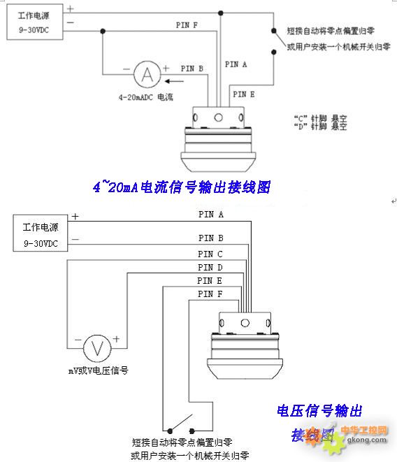

ѹÁ¦Êä³öÐźÅ
4-20mA¡¢0-5VDC¡¢1-5VDC¡¢0.5-4.5V¡¢0-10VDC¡¢3mV/V

½ÓÏßʾÒâͼ
