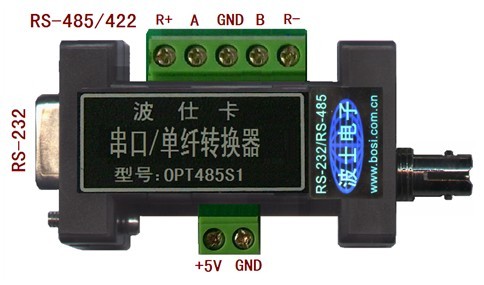

²¨Ê˵ç×ÓµÄOPT485S1΢ÐÍRS-232/485/422/µ¥ÏËת»»Æ÷¿ÉÒÔʵÏÖRS-232¡¢RS-485»òRS-422µÄµ¥ÏËË«ÏòͨÐÅת»»¹¦ÄÜ£¬Ö»ÓÐDB-9/DB-9ת½ÓºÐ´óС£¬¶øÇÒµ¥Ä£¶àģͨÓá£
ÓÉÓÚ²ÉÓùâÏË×÷ΪͨÐÅ´«Êä½éÖÊ£¬¾ßÓи߸ôÀëµçѹ¡¢·Àµç´Å¸ÉÈÅ¡¢¿¹À×»÷µÈÓŵ㡣²¨Ê˹âÏËת»»Æ÷¹ã·ºÓÃÓÚ¸÷ÖÖ¹¤Òµ¹ý³Ì¿ØÖÆ¡¢·Ö²¼Êý¾Ý²É¼¯µÈ³¡ºÏ¡¢ÌرðÊʺϵçÁ¦ÏµÍ³×Ô¶¯»¯¡¢½»Í¨¿ØÖƵȲ¿ÃÅ¡£×¨Àû²úÆ·ZL03335087£¬½÷·À¼Ùð¡£
¶þ¡¢Ó²¼þ°²×°
   OPT485S1ÐÍRS-232/485/422/µ¥ÏËת»»Æ÷µÄÍâÐÎΪDB-9/DB-9ת½ÓºÐ´óС£¬ÆäÖÐDB-9£¨¿××ù£©Ò»¶ËÖ±½Ó²åÔÚ¼ÆËã»úµÄDB-9оRS-232Õë×ùÉÏ£¬²úÆ·²àÃæÓнÓÏß¶Ë×Ó½ÓRS-485¡¢RS-422ÒÔ¼°5VµçÔ´£¬Ê¹ÓÃÒ»¸öST¹âÏ˽ÓÍ·¡£OPT485S1ÐèÒªÍâ½ÓÖ±Á÷5VµçÔ´¡£OPTϵÁйâÏËת»»Æ÷ʹÓÃʱ·¢ËÍÆ÷ͨ¹ý¹âÏ˽ӶԷ½µÄ½ÓÊÕÆ÷¡£
OPT485S1·ÖΪT3R5ºÍT5R3Á½ÖÖÐͺţ¬±ØÐëT3R5ºÍT5R3Åä¶ÔʹÓá£Ê¹ÓÃʱ·¢ËÍÆ÷STͷͨ¹ý¹âÏ˽ӶԷ½µÄ½ÓÊÕÆ÷STÍ·¡£×¢Òâ±£³Ö¹âÏËת»»Æ÷µÄST×ù¡¢¹âÏ˵ÄSTÍ·µÄÇå½à£¬Èç¹û²»Á¬½ÓʱÇëÒ»¶¨½«ST×ùºÍSTÍ·ÓÃÏàÅäÌ×µÄÏðƤÈû×Ó¸Çס¡£
Èý¡¢ÐÔÄÜÌØµã
    ²¨Ê˵ç×ÓµÄOPT485S1´®¿Ú/µ¥ÏËת»»Æ÷×î¸ßËÙÂÊ115.2Kbps£¬ÎÞÐèÈκγõʼ»¯ÉèÖã¡¶ÀÓв¨ÊËÁãÑÓʱ×Ô¶¯ÊÕ·¢×ª»»¼¼Êõ£¬È·±£ÊʺÏËùÓÐÈí¼þ!
¹âÏ˽ӿÚ
ST£¨¿ÉתFC¡¢SC£©
 ¹â²¨³¤
T5R3£¨·¢1550nm£¬ÊÕ1300nm£©
´«Êä½éÖÊ
µ¥Ä£¹âÏË£¬¶àÄ£¹âÏ˾ù¿É
T3R5£¨·¢1300nm£¬ÊÕ1550nm£©
  Í¨ÐÅ
  ·½Ê½
½ÓÏß¶Ë×Ó£¨RS-485/422£©
³ß´ç¼°ÖØÁ¿
DB-9/9ת½ÓÍ·´óС¡¢90¿Ë
DB-9¿×RS-232
´«Êä¾àÀë
15Km£¨µ¥Ä££©£¬1Km£¨¶àÄ££©
µçÔ´
5VÖ±Á÷£¬¹¦ºÄ<100mA
ÊÊÓùâÏË
50/125¡¢62.5/125¡¢100/140um
ËÄ¡¢ÍâÐÎͼ
²¨Ê˵ç×ÓÅäÌ×Ìṩ¸÷ÖÖ³¤¶È¹âÏËÒÔ¼°½ÓÍ·¡£OPT485S1¶ÔÍâ½Ó5VµçÔ´ÒªÇó5V£¨¡À0.5V£© £¬²úÆ·¹¦ºÄСÓÚ100mA£¬²úÆ·ÅäÌ×ÓÐ΢ÐÍ¿ª¹ØÎÈѹµçÔ´¡£
