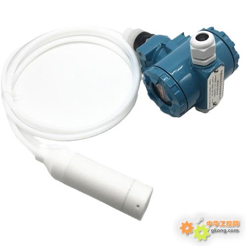

²úÆ·Ãû³Æ£º ÎÛË®´¦ÀíҺλ¼Æ ͶÈëʽҺλ±äËÍÆ÷
ÐÍ ºÅ£º Һλ±äËÍÆ÷
Æ· ÅÆ£º ïÉеç×Ó
ͶÈ루Һѹ£©Ê½ÒºÎ»±äËÍÆ÷ ͶÈ루Һѹ£©Ê½ÒºÎ»±äËÍÆ÷²ÉÓøßÐÔÄܵÄÀ©É¢¹èѹ×èʽѹÁ¦´«¸ÐÆ÷×÷Ϊ²âÁ¿Ôª¼þ£¬¾­¹ý¸ß¿É¿¿ÐԵķŴó´¦Àíµç·¼°¾«ÃÜζȲ¹³¥£¬½«±»²â½éÖʵıíѹ»ò¾øÑ¹×ª»»Îª±ê×¼µÄµçѹ»òµçÁ÷Ðźš£±¾²úÆ·Ìå»ýСÇÉ£¬Ê¹Óð²×°·½±ã£¬Ö±½ÓͶÈëË®Öм´¿É²âÁ¿³ö±äËÍÆ÷Ä©¶Ëµ½ÒºÃæµÄҺλ¸ß¶È¡£
  • ÌØµã
²ÉÓÃÏȽøµç·´¦Àí¼¼Êõ£¬ÐÔÄÜÎȶ¨¡¢¸ßÁéÃô¶È£»¶àÖÖÁ¿³Ì£¬¿É²â200m(Ë®ÖùѹÁ¦)£»²ÉÓÃ316L²»Ðâ¸Ö¸ôÀëĤƬ£¬ÊÊÓÃÓÚ¶àÖÖ²âÁ¿½éÖÊ£»ÅäÖÃÁé»î£¬¸ù¾ÝÐèÒª¿ÉÑ¡Ôñ²»Í¬ÅäÖã»Ò»Ìåʽ¡¢·ÖÌåʽ¿ÉÑ¡£»·´¼«ÐԺ͹ýµçѹ±£»¤£»¿¹³å»÷¡¢·ÀÀ×»÷Éè¼Æ£»¼¤¹âµ÷×èζȲ¹³¥£¬Áãµã¡¢Á¿³Ì¿ÉÏÖ³¡µ÷½Ú£»·¶Î§¿í¿¹¸¯Ê´£¬ÊÊÓÚ¶àÖÖ½éÖÊ£»¹ýÔØ¼°¿¹¸ÉÈÅÄÜÁ¦Ç¿£¬ÐÔÄÜÎȶ¨¡£
  • Ó¦ÓÃ
¹¤ÒµÏÖ³¡ÒºÎ»²âÁ¿Óë¿ØÖÆ¡¢³ÇÊй©Ë®¼°ÎÛË®´¦Àí¡¢Ê¯ÓÍ¡¢»¯¹¤¡¢µç³§¡¢Ë®Îļà²â¡¢Ë®¿â¡¢´ó°Ó¡¢Ë®µç½¨ÉèµÈÁìÓòµÄҺλµÄ²âÁ¿Óë¿ØÖÆ¡£
  • ¼¼Êõ²ÎÊý
²âÁ¿ÐÎʽ¼°·¶Î§ 0¡«1¡«200mH2O
ÔÊÐí¹ýÔØ 2±¶ÂúÁ¿³ÌѹÁ¦
¹¤×÷ÎÂ¶È -20¡«80¡æ
ζȲ¹³¥ -10¡«70¡æ
´æ´¢ÎÂ¶È -40¡«80¡æ
׼ȷ¶È£¨°üº¬·ÇÏßÐÔ¡¢Öظ´ÐÔ¡¢³ÙÖÍ£© 0.2%FS(µäÐÍ) 0.5%FS
Îȶ¨ÐÔÎó²î 0.2%FS(µäÐÍ)£¬0.5%FS
ÎÂÆ¯ÏµÊý 0.01%FS(µäÐÍ£¬Á¿³Ì²»Ð¡ÓÚ5mH2O)
0.03%FS(µäÐÍ£¬Á¿³ÌСÓÚ5mH2O)
Êä³öÐźŠ(4¡«20)mA(¶þ/ÈýÏßÖÆ)¡¢(0¡«10/20£©mA
(0¡«5)V¡¢(1¡«5)V¡¢)0¡«10)V
¹©µçµçÔ´ 15¡«36 VDC(±ê¶¨µçѹ24VDC)
¸ºÔØ(Ω) µçÁ÷Êä³öÐÍ<(U-15V)/0.02A¡¢ µçÁ÷Êä³öÐÍ>5K
Íâ¿Ç²ÄÁÏ ºÏ½ðÂÁ
OÐÍȦ ·úÏð½º
ĤƬ 316L²»Ðâ¸Ö
µçÀ רÓ÷ÀË®Í¸ÆøµçÀÂ
·À»¤µÈ¼¶ IP68(ѹÁ¦´«¸ÐÆ÷²¿·Ö)£¬IP65£¨½ÓÏߺбäËÍÆ÷²¿·Ö£©
