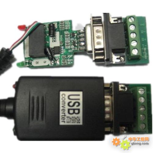

²úÆ·ÌØµã¹æ¸ñ
ÄÚ½¨15 KV ESD±£»¤
2 KV¹âµç¸ôÀë±£»¤(½öAR101PI)
COM¿Ú¼ÇÒ书ÄÜ£¬·½±ãά»¤Ö÷»úCOM¿ÚÁбí
×Ô¶¯Ê¹ÄÜ¿ØÖÆRS485Ë«ÏòÊý¾Ý
·ûºÏTIA/EIAµÄRS422/485±ê×¼
RS485/422×î¶à¹Ò½Ó32¸öÉ豸
×ÜÏßµçÔ´¹©µç¹¤×÷
Ö§³ÖUSB 1.1£¬2.0£¨È«ËÙ£©
Á¬½ÓÆ÷£ºUSB AÐÍ
Á¬½ÓÆ÷£ºDB9Õëʽ
Ïß³¤£º1Ã×£¨±ê×¼£©»ò0.1Ã×
ȫ˫¹¤·¢ÉäÆ÷ºÍ½ÓÊÕÆ÷£¨TXDºÍRXD£©
RS-422£ºTxD+(A)£¬TxD-(B)£¬RxD+(A)£¬RxD-(B)£¬GND
4ÏßRS-485£ºTxD+(A)£¬TxD-(B)£¬RxD+(A)£¬RxD-(B)£¬GND
2ÏßRS-485£ºData+(A)£¬Data-(B)£¬GND
FIFO£º512×Ö½ÚµÄË«ÏòÊý¾Ý»º³åÆ÷£¬256×Ö½ÚµÄÊä³ö»º³åºÍ256×ֽڵĴ«È뻺³åÇø
²¨ÌØÂÊ£º50 bps ~ 921.6 Kbps
Êý¾Ýλ£º5£¬6£¬7£¬8
ֹͣλ£º1£¬1.5£¬2
УÑéλ£ºNone£¬Even£¬Odd£¬Space£¬Mark
Á÷¿Ø£ºRTS/CTS£¬XON/XOFF
Ö§³ÖÒÔϲÙ×÷ϵͳ£º
      - Windows 2000 SP4
      - Windows XP SP2 and above (32 & 64 bit)
      - Windows Server 2003 (32 & 64 bit)
      - Windows Vista (32 & 64 bit)
      - Windows 7 (32 & 64 bit)
      - Windows Server 2008 / 2008 R2 (32 & 64 bit)
      - Windows 8 (32 & 64 bit)
      - Windows Server 2012
      - Mac OS£¬Linux²Ù×÷ϵͳ£¬ºÍWinCE
¹¤×÷ζȣº-40 ~ 85 °C
¹¤×÷ʪ¶È£º5 ~ 95% RH
´æ´¢Î¶ȣº-60 ~ 85 °C
