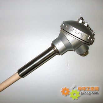

²úÆ·Ãû³Æ£º ±±¾©¸ßβ¬îîÈȵçż
ÐÍ ºÅ£º KZW/S-130
²úÆ·Ãû³Æ£º²¬îîÈȵçż
Æ· ÅÆ£ºÀ¥ÂØÖдó
¹æ ¸ñ£º1000mm£¬Î޹̶¨£¬¸ÕÓñ¹Ü
¹¦ ÄÜ£º²âÎÂ
ÐÍ ºÅ£ºKZW/S-130
³ß ´ç£º¿É¸ù¾Ý¿Í»§ÐèÇó¶¨×ö
²Ä ÖÊ£º²¬îîË¿£¬±£»¤¹Ü¸ÕÓñ
ÑÕ É«£º¼ûͼƬ
²¬îîÈȵçż¹¤×÷Ô­Àí¼°²úÆ·¸ÅÊö
KZWϵÁй¤ÒµÓò¬îîÈȵçżÓֽйó½ðÊôÈȵçż£¬Ëü×÷ΪζȲâÁ¿´«¸ÐÆ÷,ͨ³£ÓëζȱäËÍÆ÷¡¢µ÷½ÚÆ÷¼°ÏÔʾÒDZíµÈÅäÌ×ʹÓÃ,×é³É¹ý³Ì¿ØÖÆÏµÍ³£¬ÓÃÒÔÖ±½Ó²âÁ¿»ò¿ØÖƸ÷ÖÖÉú²ú¹ý³ÌÖÐ0-1800¡æ·¶Î§ÄÚµÄÁ÷Ìå¡¢ÕôÆûºÍÆøÌå½éÖÊÒÔ¼°¹ÌÌå±íÃæµÈζȡ£²¬îîÈȵçżÊÇÓÉÁ½ÖÖ²»Í¬³É·ÖµÄµ¼ÌåÁ½¶Ë½ÓºÏ³É»ØÂ·Ê±,µ±Á½½ÓºÏµãζȲ»Í¬Ê±£¬¾Í»áÔÚ»ØÂ·ÄÚ²úÉúÈȵçÁ÷¡£Èç¹ûÈȵçżµÄ¹¤×÷¶ËÓë²Î±È¶Ë´æÔÚÓÐβîʱ£¬ÏÔʾÒÇ±í½«»áÅúʾ³öÈȵçż²úÉúµÄÈȵçÊÆËù¶ÔÓ¦µÄζÈÖµ¡£²¬îîÈȵçżµÄÈȵ綯ÈȽ«Ëæ×ŲâÁ¿¶ËζÈÉý¸ß¶øÔö³¤£¬ËüµÄ´óСֻÓëÈȵçż²ÄÁϺÍÁ½¶ËµÄζÈÓйء¢ÓëÈȵ缫µÄ³¤¶È¡¢Ö±¾¶Î޹ء£¸÷ÖÖ²¬îîÈȵçżµÄÍâÐγ£ÒòÐèÒª¶ø¼«²»Ïàͬ£¬µ«ÊÇËüÃǵĻù±¾½á¹¹È´´óÖÂÏàͬ£¬Í¨³£ÓÉÈȵ缫¡¢¾øÔµÌ×±£»¤¹ÜºÍ½ÓÏߺеÈÖ÷Òª³É·Ö×é³É¡£
