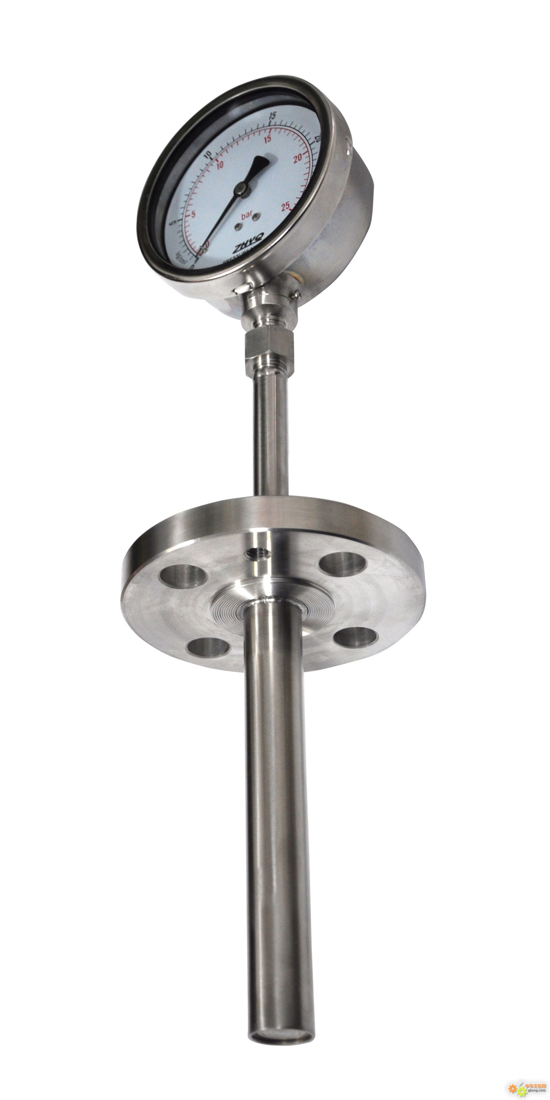

²úÆ·ÃèÊö£º
    PT124Y-617·¨À¼Ð͸ßÎÂÈÛÌåѹÁ¦±í,²ÉÓõ¹úÔ­×°½ø¿Ú»úо£¬²ÉÓÃĤƬ¸ôÀë¼¼Êõ¡¢²¨ÎÆÄ¤Æ¬º¸½Ó£¬ÎÂÆ¯Ð¡£¬·¨À¼°²×°½á¹¹£¬ÐÔÄÜÎȶ¨¿É¿¿¡£Ñ¹Á¦ÏÖ³¡Ö¸Õëָʾ£¬ÎÞÐèµçÔ´¹©µç¡£

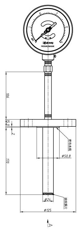

²úÆ·³ß´çͼ£º
                                   PT124Y-617²úÆ·³ß´çͼ£¬·¨À¼Ð͸ßÎÂÈÛÌåѹÁ¦±í
