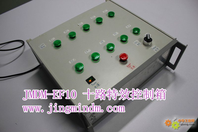

1¡¢Ó°ÔºÌØÐ§¿ØÖÆÆ÷ϵͳ¼ò½é
ÉîÛÚÊо«ÃôÊý×Ö»úÆ÷ÓÐÏÞ¹«Ë¾»ùÓÚ¶àÄêµÄ¹¤Òµ¼¶ÖÇÄÜ¿ØÖƺÍ3D/5D/7D¶¯¸ÐÓ°ÔºÐÐÒµ¾­Ñ飬×ÔÖ÷Ñз¢µÄJMDM-EF10ÌØÐ§¿ØÖÆÏäÊÇÒ»¿î×î¶à¿ÉÒÔ¿ØÖÆÊ®Â·ÌØÐ§µÄ¿ØÖÆÏ䣬¾ßÓп¹Ç¿¸ÉÈÅÄÜÁ¦¡¢¹¦ÄÜÇ¿´ó¡¢Îȶ¨¿É¿¿µÄ¹¤Òµ¿ØÖÆÆ÷¡£ËüÓ²¼þ²ÉÓþßÓиßÐÔÄÜ¡¢¹¤Òµ¼¶±ðµÄ½ø¿Úµ¥Æ¬»ú¼°Á㲿¼þ¡¢×¨ÒµµÄÎȶ¨ÐÔ¡¢¿¹¸ÉÈŵç·Éè¼Æ£»¸Ã¿ØÖÆÆ÷¿Éͨ¹ý¾«Ãô2D/3DÓ°ÔºÌØÐ§¿ØÖÆÈí¼þ£¬ÊµÏÖ¿ØÖƹη硢ÏÂÓê¡¢Åç»ð¡¢ÉÁµç¡¢ÑÌÎí¡¢ÅÝÅÝ¡¢³ö¹í¡¢Ñ©»¨¡¢É¨ÍȵÈÓ°Ôº»·¾³ÌØÐ§ºÍӰƬÇé½ÚµÄͬ²½Êä³ö£¬ÔöÇ¿¹ÛÖÚµÄÉíÁÙÆä¾³¸ÐºÍ³Áû¸Ð£¬Ìá¸ßÓéÀÖÌåÑ飬¼Ì¶øÌá¸ßÓ°ÔºµÄ¾­¼ÃÐ§Òæ¡£
2¡¢JMDM-EF10²úÆ·¹¦ÄܽéÉÜ
(1)´øÓÐRS485ͨÐŶË×ÓºÍRS232ͨÐŶ˿ڣ¬RS232ºÍRS485¿ÉÒÔͨ¹ýÁ½¸öÌøÏßñÀ´½øÐÐÇл»¡£
    (2)¿ÉÒÔͨ¹ý¾«ÃôÌØÐ§²¥·ÅÈí¼þ¸ù¾ÝµçÓ°Çé½ÚÌí¼ÓÏàÓ¦µÄÌØÐ§¶¯×÷£¬±ÈÈçµçÓ°²¥·Åµ½µÚÊ®·ÖÖÓ21ÃëʱºòÓÐÏÂÓêÌØÐ§£¬Õâʱ¿Éͨ¹ý¾«ÃôÌØÐ§²¥·ÅÈí¼þÔÚ¸ÃλÖÃÌí¼ÓÏÂÓêÌØÐ§Êä³ö¡£·ÅµçӰʱ¾«ÃôÌØÐ§²¥·ÅÈí¼þ¾Í¿ÉÒÔÔÚӰƬ²¥·Åµ½µÚÊ®·ÖÖÓ21ÃëʱÊä³öÏÂÓêÌØÐ§¡£
  1. ¾ß±¸ÊÖ¶¯¿ØÖƺÍ×Ô¶¯¿ØÖÆÁ½¸ö¹¤×÷ģʽ£¬µ±Ñ¡Ôñ×Ô¶¯¿ØÖÆÄ£Ê½Ê±µçÓ°²¥·Åµ½¾ßÌåµÄʱ¼äµã¾ÍÊä³öÏàÓ¦µÄÌØÐ§¡£µ±Ñ¡ÔñÊÖ¶¯¹¤×÷ģʽʱ£¬ÊÖ¶¯°´ÏàÓ¦µÄ¿ª¹Ø¾ÍÊä³öÏàÓ¦µÄÌØÐ§¡£
  2. 10·¼ÌµçÆ÷Êä³ö£¬Ã¿Â·Êä³ö×î´óµçÁ÷Ϊ20A¡£×î´óµçѹΪ220V¡£
3¡¢Ó¦Óó¡ºÏ
    ¸ÃÌØÐ§¿ØÖÆÆ÷¿É¹ã·ºÓÃÓÚ¸÷ÖÖ2DÓ°Ôº¡¢3DÓ°ÔºµÄÌØÐ§Êä³ö¿ØÖÆ¡£Ê¹ÄãÔÚ²¥·ÅÆÕͨԺÏßµçÓ°µÄʱºòÔö¼ÓһЩ»·¾³ÌØÐ§¡£Ôö¼ÓµçÓ°²¥·ÅµÄȤζºÍ·ÕΧ¡£
  • ¼¼Êõ²ÎÊý
1¡¢10·´ó¹¦Âʼ̵çÆ÷Êä³ö£¬×î¶à¿ÉÒÔ¿ØÖÆÊ®¸öÌØÐ§£¬Ã¿Â·×î´ó³ÐÔØµçѹÊÇ220V£¬³ÐÔØµçÁ÷ÊÇ20A¡£
2¡¢¾«ÃôÌØÐ§²¥·ÅÈí¼þ¿Éͨ¹ýRS232»òRS485ͨÐÅ·½Ê½¿ØÖƾ«ÃôÌØÐ§¿ØÖÆÏäµÄÌØÐ§Êä³ö£¬Ê¹ÌØÐ§Êä³öÄܸúÉÏ֮ǰµÄ±àÖÆµÄÌØÐ§¶¯×÷£»
3¡¢ÓÐÊÖ¶¯×Ô¶¯Çл»Ä£Ê½£»
4¡¢ÔÚÊÖ¶¯Ä£Ê½Ï£¬ÓÐÊ®¸öÏàÓ¦µÄ°´Å¥£¬°´ÏàÓ¦µÄ°´Å¥¾ÍÊä³öÏàÓ¦µÄÌØÐ§£»
5¡¢ÓÐ1 Â·±ê×¼µÄRS232 ´®ÐÐͨÐŽӿڣ¬¿ÉÒÔͨ¹ý¶Ì·ñÇл»³ÉRS485½øÐÐͨÐÅ£¬¿ÉÓÃÓÚ¶à»ú×éÍø£»
6¡¢¿ÉÓþ«ÃôÌØÐ§²¥·ÅÈí¼þ²É¼¯Ó°Æ¬µÄÌØÐ§¶¯×÷ºÍ²¥·ÅӰƬµÄÌØÐ§¶¯×÷£»
7¡¢¿ØÖÆÆ÷¹¤×÷µçÔ´£º±êÅä220V½»Á÷¡£×î´ó¹¤×÷µçÁ÷Ϊ1A£»
9¡¢ÍâÐγߴ磺½ô´ÕÐÍ»ú¿Ç£¬ÌØÐ§¿ØÖÆÏä»ú¿Ç³ß´ç£º³¤375mm* ¿í360mm*¸ß165mm£¬¿É¹Ì¶¨ÔÚ¹¤ÒµµçÄÔ»úÏäÀïÃæ£¬Ò²¿ÉÓÃÂݶ¤¹Ì¶¨°²×°£»
  • ¹æ¸ñ
  1. ¹¤×÷ζȣº-10~+65°C£»
  2. ´¢´æÎ¶ȣº-20~+80°C £»
  3. ʪ¶È£º5~95% ÎÞÄý½á £»
  4. ¹¦ºÄ(ÎÞÍⲿÉ豸)£º220V¡¢0.5A (µäÐÍÖµ) £»
  • ʹÓÃ˵Ã÷£º
1¡¢´ò¿ªËæ²úÆ·¸½Ë͵ĵç×Ó°æ¼¼Êõ×ÊÁÏ£º²úÆ·×ÊÁÏ¡¢½ÓÏß˵Ã÷¡¢ÌØÐ§²¥·ÅÈí¼þ£¬×ÐϸÔÄÀÀ¼¼Êõ×ÊÁÏ£»
2¡¢¸ù¾Ý²úƷ˵Ã÷ÊéËù¸½½ÓÏßͼ½ÓºÃ¿ØÖÆÆ÷Óë²¥·ÅµçÄÔÖ®¼äµÄ½ÓÏß¡¢²¥·ÅµçÄÔÓë¿ØÖÆÆ÷Ö®¼ä²ÉÓô®¿ÚͨÐÅ£¨RS232»òRS485½Ó¿Ú£©£»
3¡¢×Ðϸ¼ì²éÎÞÎóºó£¬½ÓºÃ¿ØÖÆÆ÷µçÔ´£»
4¡¢¿ØÖÆÆ÷Éϵ磬´ò¿ªµçÔ´¿ª¹Ø£¬µçԴָʾµÆÏÔʾ
5¡¢°²×°¾«Ãô¹«Ë¾µÄÌØÐ§²¥·ÅÈí¼þ£¬¾ßÌåÈí¼þʹÓÃ˵Ã÷¼û¡¶¾«ÃôÊý×Ö3DÓ°Ôº¿ØÖÆÈí¼þ-±à¼­¶ËʹÓÃ˵Ã÷Êé.doc¡·£»
