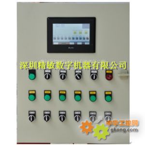

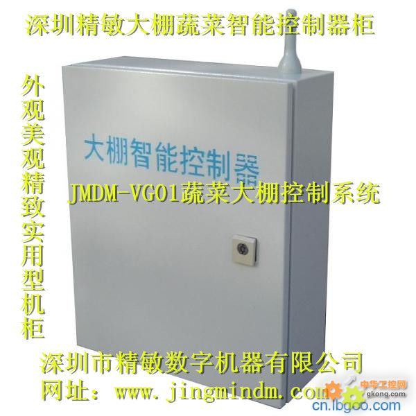

   ¾«Ãô¹«Ë¾ÍƳöµÄÖÇÄÜÊ߲˴óÅï¿ØÖÆÏµÍ³£¬ÓÖ½ÐÖÇÄÜÎÂÊÒ¿ØÖÆÏµÍ³£¬ÊÇרÃÅΪũҵÎÂÊÒ¡¢Å©Òµ»·¾³¿ØÖÆ¡¢ÆøÏó¹Û²â¿ª·¢Éú²úµÄ»·¾³×Ô¶¯¿ØÖÆÏµÍ³¡£
Ò»¡¢JMDM-VG01Ê߲˴óÅO³É¿ØÖÆÏµÍ³ ¿ÉÒÔ×öʲô£¿
1¡¢¿É²âÁ¿ÎÂÊÒ´óÅïÄڵĻ·¾³Î¶ȡ¢»·¾³Êª¶È¡¢¹âÕÕÇ¿¶È¡¢ÍÁÈÀζȡ¢ÍÁÈÀË®·Ö¡¢¶þÑõ»¯Ì¼Å¨¶ÈµÈũҵ»·¾³Òò×Ó£»
2¡¢¸ù¾ÝÎÂÊÒ×÷ÎïÉú³¤ÒªÇó£¬×Ô¶¯¿ØÖÆ¿ª¹Ø´°¡¢¾íĤ¡¢·ç»úʪÁ±¡¢ÉúÎï²¹¹â¡¢¹à¸ÈÊ©·ÊµÈ²Ù×÷£»
3¡¢×Ô¶¯µ÷¿ØÎÂÊÒÄÚ»·¾³£¬´ïµ½ÊÊÒËÖ²ÎïÉú³¤µÄ·¶Î§£¬ÎªÖ²ÎïÉú³¤Ìṩ×î¼Ñ»·¾³£»
4¡¢¿ÉÒÔʹÎÂÊÒÔËÐÐÓÚ¾­¼Ã½ÚÄÜ״̬£¬ÊµÏÖÎÂÊÒµÄÎÞÈËÖµÊØ×Ô¶¯»¯ÔËÐУ¬¼õÇáÈËÔ±ÀͶ¯Ç¿¶È£¬½µµÍÎÂÊÒÄܺĺÍÔËÐУ»
5¡¢ÄÜ¼à¿Ø¸÷ÏîÊý¾Ý£¬Í¨¹ýGPRS´«µ½ÍøÂ磬Óû§¿ÉÔÚÈκÎÓÐÍøÂçµÄµØ·½²é¿´£¬²¢¿É¸ù¾ÝÆäÓû§È¨ÏÞ½øÐÐÏàÓ¦µÄ²Ù×÷£»
6¡¢¿ÉÔ¶³Ì¿ØÖÆÌï¼äµç´Å·§£¬²¢É趨²»Í¬µÄ¹à¸ÈÊ©·Ê·½°¸£»Ô¶³Ì¿ØÖƼ°·ÃÎÊÉ趨²»Í¬µÄȨÏÞ£¬Ô¶³Ì·ÃÎʶ¼ÓмǼ±£´æ£»
7¡¢ÊÕ¼¯µÄÊý¾ÝÄÜÉ趨¾¯½äÖµ£¬Èç¹û³¬³ö¾¯½äÖµ¿É·¢Ë;¯±¨µ½¿ØÖÆÊÒ»òÕßÊÖ»úÉÏ£¬ÒÔÃâ·¢ÉúÒâÍâÇé¿ö£»
8¡¢ÖÇÄÜÊ߲˴óÅï¿ØÖÆÏµÍ³¿ÉÍê³É×Ô¶¯¹à¸È¡¢×Ô¶¯ÅçÒ©¡¢×Ô¶¯Ê©·Ê£¨ÒºÌ¬·Ê£©µÈ¹¦ÄÜ£¬ÇÒ²»ÐèÈ˹¤¸ÉÔ¤£¬Ö»ÐèÔڰ칫ÊÒ½øÐÐÊó±ê²Ù×÷±ã¿ÉÇáËÉÍê³ÉÉÏÊö¸´ÔÓ¶¯×÷£¬¶øÇÒϵͳ¿ÉÉ趨×Ô¶¯Ä£Ê½£¬ÀýÈç¡¢¸ù¾Ýµ±Ç°×Ô¶¯²É¼¯µÄË®·ÖÀ´Åж¨ÊÇ·ñÐèÒª¹à¸ÈµÈ¶¯×÷£¬ÊµÏÖϵͳµÄ×Ô¶¯»¯¡£
9¡¢ÊµÏÖũҵÊ߲˴óÅïµÄÐÅÏ¢»¯¡¢ÖÇÄÜ»¯¡¢È«³Ì×Ô¶¯»¯¡¢¸ßЧ»¯¹ÜÀíºÍÔËÐУ¬½ÚÄÜ»·±£¡¢Ê¡Á¦Ê¡È˹¤£¬½µµÍÊ߲˴óÅïÈ˹¤¹ÜÀí³É±¾£¬Ìá¸ßÉú²úЧÂʺ;­¼ÃÐ§Òæ£¬ÊÇδÀ´Å©ÒµÐÅÏ¢»¯·¢Õ¹µÄ·½Ïò¡£

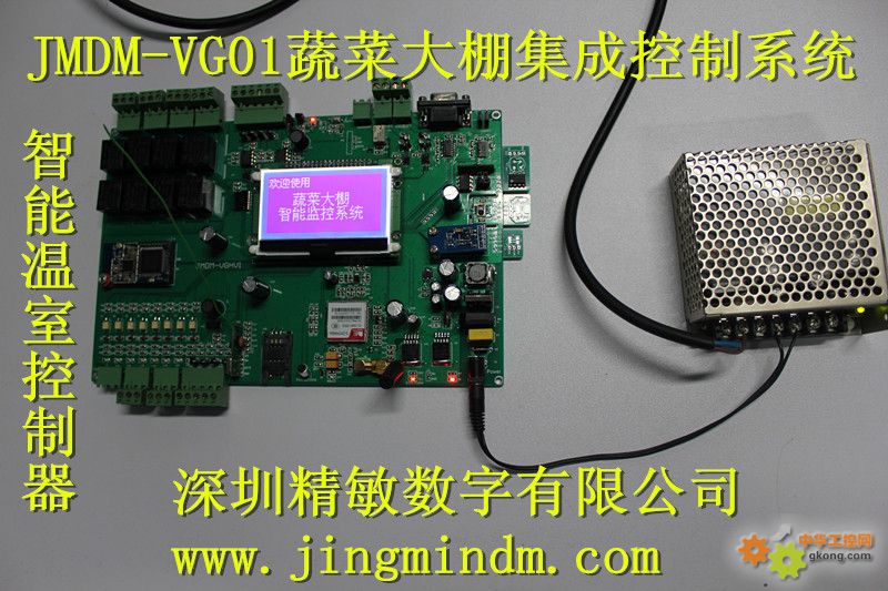

¶þ¡¢JMDM-VG01Ê߲˴óÅO³É¿ØÖÆÏµÍ³µÄºËÐÄ¿ØÖÆÆ÷½éÉÜ
²ÉÓù¤Òµ¼¶ARM×÷ΪÖ÷¿ØÐ¾Æ¬£¬ÊÇÒ»¿îÉè¼Æ×¨Òµ¡¢¿¹Ç¿¸ÉÈÅÄÜÁ¦¡¢¹¦ÄÜÇ¿´ó¡¢Îȶ¨¿É¿¿µÄ¹¤Òµ¿ØÖÆÆ÷£¬¾ß±¸ÒÔϹ¦ÄÜ¡¢
  1¡¢ÓÐ8·Êý×ÖÁ¿ÊäÈ룬8·Êý×ÖÁ¿Êä³ö£¬¿ÉÍâ½ÓÈËÌå¸ÐÓ¦£¬ºìÍâ¶ÔÉ䣬Ñ̸еȴ«¸ÐÆ÷£¬Ò²¿É¿ØÖÆÒ£¿Ø¿ª¹Ø£¬Ë®·§£¬ÕÕÃ÷µÆ£¬µç»úµÈÍⲿ¹¤×÷Æ÷¼þ£»
  2¡¢ÓÐ4·0-10VÄ£ÄâÁ¿ÐźÅÊäÈ룬4·0-10VÄ£ÄâÁ¿ÐźÅÊä³ö£¬¿ÉÍâ½Ó¸÷ÖÖÄ£ÄâÁ¿ÊäÈëµÄ´«¸ÐÆ÷£¬ÀýÈçÍÁÈÀÎÂʪ¶È´«¸ÐÆ÷£¬ÍÁÈÀËá¼î¶È´«¸ÐÆ÷£¬Ò²¿É¿ØÖÆ±äÆµÆ÷µ÷ËÙ,±ÈÀý·§µ÷Á÷Á¿µÈÐèҪģÄâÁ¿Êä³öµÄÓ¦Óó¡ºÏ¡£
  3¡¢128*64Òº¾§ÏÔʾģ¿é£¬¾ßÓÐÓѺõÄÈË»ú½»»¥½çÃæ¡£
  4¡¢¼¯³ÉÁËÎÞÏßWIFIÉÏÍø¹¦ÄÜ£¬¿Éͨ¹ýWIFIÓëÔ¶³ÌÍøÂçÊÕ·¢Êý¾Ý£¬Ò²¿É½ÓÊÜÊÖ»ú£¬Æ½°åµçÄÔµÈÖն˵ĿØÖÆ¡£
  5¡¢¼¯³ÉÁË433M·¢ÉäͨÐÅÄ£¿é¡£¿Éͨ¹ý433ÎÞÏß¿ØÖÆÒ£¿Ø¿ª¹ØµÈÍâÉ裻
  6¡¢¼¯³ÉÁË315M½ÓÊÕͨÐÅÄ£¿é£¬¿É½ÓÊÕ¸÷ÖÖÒ£¿ØÆ÷·¢À´µÄÊý¾Ý£»
  7¡¢¼¯³ÉÁËGSM/GPRSͨÐÅÄ£¿é£¬¿É²åÈëSIM¿¨£¬Ö§³ÖGPRSÍøÂç¡¢ÓïÒôͨ»°¹¦ÄÜ£¬Í¨»°Ê±Ñ¡ÓÃÑïÉùÆ÷ģʽ£»
  8¡¢¼¯³ÉÁËһ·´®¿ÚͨÐÅ£¬¿Éͨ¹ý´®¿ÚÓëÆäËüÍâÉèÉ豸ͨÐÅ£»
  9¡¢¼¯³ÉÁËһ·RS485ͨÐÅ£¬¿Éͨ¹ýRS485½Ó¿ÚÓëÆäËüÍâÉèÉ豸ͨÐÅ£»
  10¡¢¼¯³ÉÁËÖÇÄܱ¨¾¯¹¦ÄÜ£»
  11¡¢¼¯³ÉÁËζÈʪ¶È²É¼¯¹¦ÄÜ£»
  12¡¢ ¼¯³ÉÁËÒ»¸öÖ±Á÷µç»úÇý¶¯Ð¾Æ¬£¬×î´ó³ÖÐøµçÁ÷¿É´ïµ½2A.¿ÉÓÃÀ´Çý¶¯´°Á±µç»ú£¬ÃÅËøÂí´ïµÈÍâÉ裻
  13¡¢¼¯³ÉÁ˹âÕÕÇ¿¶È´«¸ÐÆ÷¡£
  14¡¢¼¯³ÉÁËC02Ũ¶È´«¸ÐÆ÷¡£
