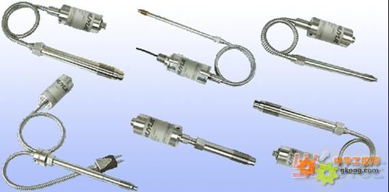

ÐÍ ºÅ£º PT616¸ßÎÂÈÛÌåѹÁ¦´«¸ÐÆ÷
PT616¸ßÎÂÈÛÌåѹÁ¦´«¸ÐÆ÷(high temperature melt pressure sensor)
²úÆ·Ãû³Æ
ÌØÕ÷ÓëÓÃ;
PT616¸ßÎÂÈÛÌåѹÁ¦´«¸ÐÆ÷ͨ¹ýÊ®¶àÄêµÄÑÐÖÆ²¢²»¶ÏµÄ¸Ä½ø£¬´Ó1998Äê3Ô¿ªÊ¼²ÉÓÃ×ÔÖ÷ÑÐÖÆµÄÐÂÐÍĤƬ£¬Ê¹¸ßÎÂÈÜÌåѹÁ¦´«¸ÐÆ÷µÄÎÂÆ¯´ó·ùϽµ£¬²¢¿ÉÔÚÇ¿Ëá¼î»·¾³ÖÐʹÓᣱÈÔ­²úÆ·ÔÚʹÓÃÊÙÃüÉÏÑÓ³¤5¡«10±¶£¬²¢¼ÌÐø±£³Ö¹úÄÚÁìÏÈ£¬´ïµ½¹ú¼ÊͬÀàˮƽ¡£ÏÖÒÑ´óÅúÁ¿³ö¿ÚÅ·ÖÞ¼°±±ÃÀÖÞµÈ30¶à¸ö¹ú¼Ò¡£ ¡¡¡¡PTϵÁиßÎÂÈÛÌåѹÁ¦´«¸ÐÆ÷ÊÊÓÃÓÚ»¯ÏË¡¢ËÜÁÏ¡¢Ï𽺡¢Ê¯»¯µÈ¸ßÎÂÈÛÌåѹÁ¦»òÆäËüÄ͸ßεÄÁ÷ÌåѹÁ¦µÄ²âÁ¿ºÍ¿ØÖÆ¡£ÎÒ¹«Ë¾ÎüÊÕÁ˹úÍâͬÀà²úÆ·ÏȽø¼¼Êõ£¬²ÉÓýø¿ÚÔ­²ÄÁϺ͹ؼüÔªÆ÷¼þ×éÖ¯Éú²ú£¬¾ßÓй¤×÷Îȶ¨¡¢ÐÔÄܿɿ¿¡¢×¼È·¶È¸ß¡¢Êä³öÐźŴ󡢶¯Ì¬ÐÔÄܺá¢Ä͸ßÎÂÁãµãÆ¯ÒÆÐ¡µÈÓŵ㡣PTϵÁд«¸ÐÆ÷Óë±¾³§µÄPWϵÁÐÒDZíÅäÌ×ʹÓÃÄÜÂú×㲻ͬÓû§µÄ¸÷ÖÖÒªÇó£¬Ò²¿ÉÖ±½ÓÓë½ø¿ÚÒÇ±í£¨Èç:DYNISCO£©ÅäÌ×ʹÓ㬲»Ðè×öÈκε÷Õû»ò¸Ä¶¯£¬Á¬½ÓÂÝÎÆ¡¢Òý³ö½Ó²å¼þµÈÈ«²¿¼æÈÝ¡£ PT616¸ßÎÂÈÛÌåѹÁ¦´«¸ÐÆ÷(high temperature melt pressure sensor)
¼¼Êõ²ÎÊý
 ¶î¶¨Á¿³Ì£º0¡«150MPa(¹ú±êÈÎÑ¡£¬150MPaÒÔÉϿɶ¨×ö)
²âÁ¿¾«¶È£º0.5%FS¡¢1.0£¥FS¡¢1.5£¥FS(ÈÎÑ¡)
Ö÷ÒªÓÃ;£ºÈÛÌå¡¢Á÷Ìå¡¢ÆøÌå
×î¸ßζȣº538¡æ
ÂÝÎÆ³ß´ç£ºM14¡¢M22¡¢1/2"µÈ(¹ú±êÈÎÑ¡)
Ö±¸Ë/Èí¹Ü£º0¡«600/0¡«3000(mm)
¹¤×÷»·¾³£º-10¡«50¡æ£»80£¥RH
ÁãµãÎÂÆ¯£º≤0.1MPa/100¡æ
¾­¼ÃÐÍѹÁ¦´«¸ÐÆ÷¼°±äËÍÆ÷ʹÓÃÓÚËÜÁϼ·³öÐÐҵѹÁ¦²âÁ¿£¬ÓëÎÒ¹«Ë¾µÄPWϵÁÐÖÇÄÜÊý×ÖѹÁ¦±íÅäÌ×ʹÓÿÉʵÏÖѹÁ¦µÄ²âÁ¿Óë¿ØÖÆ£¬±äËÍÆ÷ϵÁвÉÓÃ24VÖ±Á÷¹©µç£¬Êä³ö±ê×¼ÐźűãÓÚ¼ÆËã»ú²É¼¯¡£PT616¸ßÎÂÈÛÌåѹÁ¦´«¸ÐÆ÷Ϊ¹úÄڹ㷺ʹÓõÄÓÅÊÆÔÚÓÚѹÁ¦²âÁ¿×¼È·¿É¿¿£¬ÐԼ۱ȸߡ£
