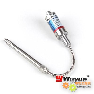

R-RϵÁиßÎÂÈÛÌåѹÁ¦´«¸ÐÆ÷(high temperature melt  pressure and temperature transducer)
ÌØÕ÷ÓëÓÃ;
R-RϵÁиßÎÂÈÛÌåѹÁ¦´«¸ÐÆ÷¸ÕÐԸˡ¢Èí¹Ü¸ôÀ롢ĤƬ¸ôÀë½á¹¹ Á¼ºÃµÄÎȶ¨ÐԺ;«¶È ÓëÃÀ¹úDynisco¡¢GEFRAN¡¢RKCµÈͬÀà²úÆ·ÍêÈ«»¥»»¡£ R-RϵÁиßÎÂÈÛÌåѹÁ¦´«¸ÐÆ÷ Ó¦ÓÃÓÚ»¯ÏË·ÄË¿¡¢¾Ûõ¥¡¢ÏðËÜ»úеµÈÉ豸µÄ¸ßÎÂÁ÷Ìå½éÖʵÄѹÁ¦²âÁ¿Óë¿ØÖÆ¡£ ͨ¹ýÅ·ÃËCEÈÏÖ¤ R-RϵÁиßÎÂÈÛÌåѹÁ¦´«¸ÐÆ÷(high temperature melt  pressure and temperature transducerr used in plastic extrusion)
¼¼Êõ²ÎÊý
1£ºÑ¹Á¦Á¿³Ì£º0¡«5MPa¡«200MPaÖ®ÄÚÈÎÑ¡
 2£º×¼È·¶È£º   +1.0%FS  ;  +0.5%FS  ;
 3£º¹¤×÷µçÔ´£º 10VDC£¨6--12VDC£©;
 4£ºÊä³öÐźţº PT131ϵÁУº1.5mv/v,2.0mV/V£¬3.3mV/V
 5£ºÐ£×¼·½Ê½£º 80%FSO+1%;
 6£ºÌ½Í·ÄÍΣº 450¡æ
 7£ºÎ¶ÈÐͺţº PT131(E;  J ;  K )
 8£ºµçÆøÁ¬½Ó£º PT131-ϵÁУºÍ¨ÓÃÐÍÎåо½Ó²å¼þ
 9£º¹ýÔØÑ¹Á¦£º1.5*FS
 9£º»úеÁ¬½Ó£º1/2"--20UNF ¡¢M14*1.5 ¡¢M18*1.5¡¢M22*1.5¡¢µÈ¶àÂÝÎÆ³ß´ç
 10£º·À¸¯ÄÍĥͿ²ã£ºÊÊÓÃÓÚ¸ßŨ¶È´Ö²Ú½éÖʵÄѹÁ¦²âÁ¿£¬¿ÉÌá¸ßÊÊÓÃÊÙÃü3-5±¶R-RϵÁиßÎÂÈÛÌåѹÁ¦´«¸ÐÆ÷
