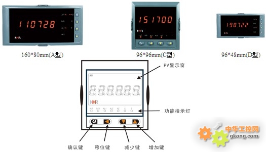

    NHR-2400ϵÁÐÆµÂÊ/תËÙ±í²ÉÓÃÈ«×Ô¶¯ÌùƬ·â×°¹¤ÒÕ£¬¾ßÓкÜÇ¿µÄ¿¹¸ÉÈÅÄÜÁ¦£¬²¢¾ßÓжàÖÖÊä³ö¹¦ÄܺͿØÖƹ¦ÄÜ£¬Óë¶àÖÖתËÙ´«¸ÐÆ÷ÅäÌ×£¬¹ã·ºÔËÓÃÓÚµçÁ¦¡¢Ê¯»¯¡¢Ò±½ð¡¢ÇṤ¡¢ÖÆÒ©¡¢º½¿ÕµÈÖî¶àÁìÓò¡£
6λLEDÊýÂëÏÔʾ£¬ÏÔʾ·¶Î§¿í£¬²¢ÇÒÏÔʾÁÁ¶È¿ÉÒÔµ÷Õû¡£
ƵÂʲâÁ¿·¶Î§£º1¡«34KHz£¬×î´óÊäÈë·ùÖµ£º24V  DC£¬×îС·Ö±æÂÊ£º0.01Hz¡£
¾ß±¸“ÉÏÏÂÏÞ±¨¾¯”¡¢“ÑÓʱ±¨¾¯”¡¢“±¨¾¯ÑÓʱ¸´Î»”¹¦ÄÜ£¬´øLED±¨¾¯µÆÖ¸Ê¾¡£
Ö§³ÖRS485¡¢RS232´®Ðнӿڣ¬²ÉÓñê×¼MODBUS RTUͨѶЭÒé¡£
Êä³ö¡¢µçÔ´¡¢Í¨Ñ¶Ï໥֮¼ä²ÉÓùâµç¸ôÀë¼¼Êõ¡£
¾ß±¸¶àÖÖÍâÐγߴ缰Ñùʽ¹©Óû§Ñ¡Ôñ¡£
Ãæ°åÇᴥʽ°´¼üÉèÖ㬲ÎÊýÉèÖöϵçÓÀ¾Ã±£´æ¡£
 ÒDZíÃæ°å
 ÒDZíÑ¡ÐÍ
