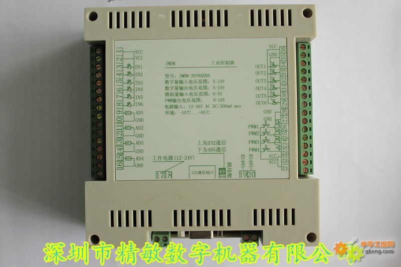

²úÆ·Ãû³Æ£º JMDM-2038¶à¹¦ÄÜÔöÇ¿°æ¿ØÖÆÆ÷
ÐÍ ºÅ£º JMDM-2038
Æ· ÅÆ£º 624
JMDM-2038²úÆ·ÊÇÒ»ÖÖ¼¯³É¶à¹¦ÄÜÐÍÈË»ú½çÃæºÍµ¥Æ¬»ú¿ØÖÆÆ÷Ò»Ìå»ú£¬ÊÇĿǰҵÄÚÒ»¿î¾­¹ý¶àÄê´ó¹æÄ£³ÉÊìµÄ¹¤ÒµÓ¦ÓᢾßÓп¹Ç¿¸ÉÈÅÄÜÁ¦¡¢¹¦ÄÜÇ¿´ó¡¢Îȶ¨¿É¿¿µÄ¹¤Òµ¿ØÖÆÆ÷¡£ËüÓ²¼þ²ÉÓþßÓиßÐÔÄÜ¡¢¹¤Òµ¼¶±ðµÄ½ø¿Úµ¥Æ¬»ú¼°Á㲿¼þ¡¢×¨ÒµµÄÎȶ¨ÐÔ¡¢¿¹¸ÉÈŵç·Éè¼Æ£¬Èí¼þ²ÉÓÃCÓïÑÔ±à³Ì£¬¾ßÓÐÁ¼ºÃµÄ¿ÉÀ©Õ¹ÐÔ£¬¿ÉʵÏÖ¶àÖÖ¹¦ÄÜ£º¿Éͨ¹ýÀ¶É«¸ßÇåÒº¾§ÆÁÈË»ú½»»¥½çÃæÉϵÄ10¸öÇá´¥¿ª¹ØÔÚÏßÉèÖòÎÊý£¬ÊµÏÖ¿ØÖƵç´Å·§¡¢Æø¸×¡¢´«¸ÐÆ÷¡¢½Ó½ü¿ª¹Ø¡¢»ô¶û¿ª¹ØµÈ£»°åÉÏÓи߾«¶ÈµÄAD²É¼¯Ð¾Æ¬£¬×î¸ß´ïµ½18λ(λÊý¸ù¾ÝÐèÒª¿ÉÈí¼þµ÷Õû)£»´ø4·20KHZµÄPWMÊä³ö£¬¿ÉÂö¿íµ÷ÖÆ¿ØÖÆ£¬¿ÉÒÔͬʱ¿ØÖƶþ·²½½øËÅ·þµç»úÁª¶¯£¬ÊÊÓÃÓÚ¸÷ÖÖÇ¿µç´Å¡¢¸ßƵ¸ÉÈŵȻ·¾³¶ñÁӵĹ¤Òµ³¡ºÏ£¬ JMDM-2038¹¤Òµ¿ØÖÆÆ÷ÒÔÎȶ¨¿É¿¿¡¢¸ßÐԼ۱ȺÍÓÅÒìµÄÐÔÄܱíÏÖ¼«´óµØÌá¸ßÁ˿ͻ§µÄÉú²úЧÂʺ;­¼ÃÐ§Òæ¡£

JMDM-2038Âö¿íµ÷ÖÆÐͺţ¨JMDM-2038ADPWM£©ºÍJMDM-2038Ä£ÄâÁ¿Ðͺţ¨JMDM-2038ADDA£©ºÍJMDM-2038µç»ú¿ØÖÆÐͺţ¨JMDM-2038M£©ºÍJMDM-2038±àÂëÆ÷¶ÁÈ¡Ðͺžù¾ß±¸ÒÔϹ¦ÄÜ£º
  1. ÓÐÒ»¸ö12864Òº¾§ÏÔʾÆÁ£¬ÁÁ¶È¿Éµ÷¡£¿ÉÏÔʾ4ÐÐ6Áбê×¼ºº×Ö¡£±³¹âµÆ¿ÉÒÔͨ¹ýÈí¼þ¿ªÆôºÍ¹Ø±Õ¡£
´øÓÐRS485ͨÐŶË×ÓºÍRS232ͨÐŶ˿ڣ¬RS232ºÍRS485¿ÉÒÔͨ¹ýÁ½¸öÌøÏßðÀ´½øÐÐÇл»¡£
  1. RS232¿ÉÒÔÉÕ¼³ÌÐò£¬ÉÕ¼³ÌÐò²»±ØÊ¹ÓÃרÃŵÄÉÕ¼Æ÷¡£
  2. ÓÐÒ»¸ö·äÃùÆ÷Êä³ö£¬¿ÉÒÔÓÃÓÚ±¨¾¯ÌáÐÑ¡£
(8)ÓµÓÐ10¸ö°´Å¥Ãæ°å¿ÉÒÔÉèÖòÎÊý¡£
JMDM-CON2038¿ÉÓÃÓÚ¸÷Êý×ÖÁ¿ÊäÈëÊä³öµÄ¿ØÖÆÏµÍ³£¬¿É¿ØÖÆÆø¸×¡¢µç´Å·§¡¢¼ÌµçÆ÷µÈ£»¿ÉÍâ½Ó¸÷ÖÖ´«¸ÐÆ÷£¬¿É¿ØÖƲ½½øµç»úºÍËÅ·þµç»ú£¬Ò²¿ÉÓÃÓÚÌæ´úPLCÓÃÓÚ¸÷ÖÖ¿ØÖƳ¡ºÏ£¨Èç¸÷ÖÖ»úÆ÷¿ØÖÆ£©£¬¹¦ÄÜÉϱÈPLC¼ÓÎı¾ÏÔʾÆ÷¸üΪǿ´ó¡¢Áé»î¡£ÐÔÄÜÎȶ¨£¬ÐԼ۱ȸߡ£
