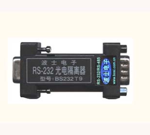

BS232T9
ÄÚÖøôÀëµçÔ´µÄÎÞÔ´ RS-232 ¹âµç¸ôÀëÆ÷
——ÄÚÖà DC/DC ¸ôÀëµçÔ´£¬Ôö¼Ó RS-232 Çý¶¯ÄÜÁ¦£¡
Ò»¡¢ÓÃ;
²¨Ê˵ç×ÓµÄBS232T9ÎÞÔ´RS232¹âµç¸ôÀëÆ÷ÄÚÖÃDC/DC¸ôÀëµçÔ´£¬ÓÃÓÚʵÏÖRS232´®ÐпڵĹâµç¸ôÀë¡£BS232T9ÓÃÓÚʵÏÖRS232´®ÐÐͨÐŵĻúÆ÷Ö®¼äµÄ¹âµç¸ôÀë¡¢±£»¤Í¨ÐŵÄRS232´®Ðпڼ°»úÆ÷¡£BS232T9ÌØ±ðÊʺÏÓÚPC»úÓë¸÷ÖÖÓÐÔ´¡¢ÎÞÔ´RS232¿Ú£¬ÓÈÆäÊÇÊÕ¡¢·¢ÐźÅÏß²»È«£¬ÐÅºÅµçÆ½Ì«µÍÒÔ¼°Çý¶¯ÄÜÁ¦Ì«ÈõµÄRS232¿ÚÖ®¼äµÄ¹âµç¸ôÀë¡£
BS232T9ÊÇÊÀ½çÉϵÚÒ»¿îÄÚÖÃDC/DC¸ôÀëµçÔ´µÄÎÞÔ´RS232¹âµç¸ôÀëÆ÷¡£
¶þ¡¢Ó²¼þ°²×°Óë¼ì²â·½·¨
BS232T9Ð͵ÄÍâÐÎΪDB9(Õë)/DB9(¿×)´óС¡¢Ö»¸ôÀë²¢ÇÒÖ»´«ËÍRS232µÄÊÕ¡¢·¢¡¢µØ¡£
½«BS232T9ÐÍRS232¹âµç¸ôÀëÆ÷µÄ¿××ùÒ»¶ËÖ±½Ó²åÔÚPC»úµÄDB9ÕëRS232²å×ù£¨Õë×ù£©ÉÏ£¬ÔòBS232T9ϵÁеÄÁíÍâÒ»¶Ë£¨Õë×ù£©Ï൱ÓÚÒ»¸öеĹâµç¸ôÀëµÄRS232¿Ú¡£BS232T9ÓëÆäËüÎÞÔ´RS232¹âµç¸ôÀëÆ÷µÄÇø±ðÔÚÓÚ£ºBS232T9µÄ9Õë¶Ë¶ÔÍâ¾ßÓÐÇý¶¯ÄÜÁ¦¡£Õâ¿ÉÒÔͨ¹ýÒÔÏ·½·¨½øÐмì²â£º1¡¢Íâ²åPC»ú£¬Óõçѹ±í¿ÉÒÔ²âÁ¿µ½×÷Ϊ¸ôÀëºóµÄTXDÐźţ¨9ÕëµÄ3½Å£©Óë¸ôÀëºóµÄGND£¨9ÕëµÄ5½Å£©Ö®¼äÓдóÔ¼9VµÄµçѹ¡£     2¡¢½«¸ôÀëºóµÄTXDÐźţ¨9ÕëµÄ3½Å£©Óë¸ôÀëºóµÄRXDÐźţ¨9ÕëµÄ2½Å£©¶Ì½Óºó£¬ÏòÍâ²åBS232T9µÄPC»úµÄRS232¿Ú·¢ËÍÊý¾Ý¿ÉÒÔ×Ô¼º½ÓÊÕµ½£¨×Ô·¢×ÔÊÕ£©£¬Èí¼þ´®¿Úµ÷ÊÔÖúÊÖ¿ÉÒÔ´Ó²¨Ê˵ç×ÓµÄÍøÕ¾ÏÂÔØ¡£
Èý¡¢Èí¼þ˵Ã÷
±¾²úÆ·¾ùÎÞÐèÈκγõʼ»¯ÉèÖã¡¶ÀÓеÄÄÚ²¿ÁãÑÓʱ×Ô¶¯ÊÕ·¢×ª»»¼¼Êõ£¬È·±£ÊʺÏËùÓÐÈí¼þ£¡
ËÄ¡¢ÐÔÄÜ˵Ã÷
BS232T9ϵÁÐRS232¹âµç¸ôÀëÆ÷ÎÞÐ빩µç£¬¸ôÀëµçѹ2500V£¬ÊʺÏÍâ²åPC»úʹÓá£Ö»¸ôÀë²¢ÇÒÖ»´«ËÍRS-232ÊÕ¡¢·¢¡¢µØ¡£BS232T9µÄͨÐÅËÙÂʱ£Ö¤×î¸ß9600bps,ʵ¼Ê19200bpsÒÔÉÏ¡£
BS232T9ÄÚÖÃ600W¿¹À×»÷ÀËÓ¿±£»¤Æ÷¡£
