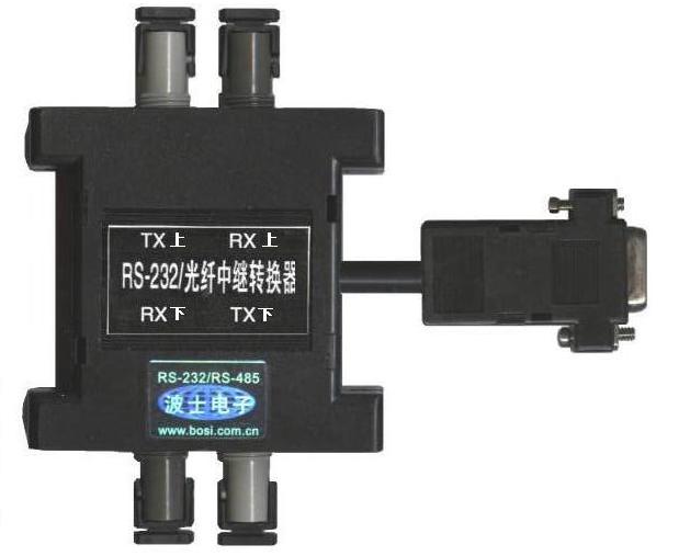

  • Ò»¡¢ÓÃ;
         ²¨Ê˵ç×ÓµÄOPT2322[S]ϵÁÐRS-232/˫·¹âÏËת»»Æ÷ÓÃÓÚ£ºÊµÏÖһ·RS-232(»òRS-485)ͬʱµ½Á½Â·¹âÏ˵Äת»»¡£ÊÇÊÀ½çÉÏ×îСµÄRS-232(485)/˫·¹âÏËת»»Æ÷¡£ÓÉÓÚ²ÉÓùâÏË×÷ΪͨÐÅ´«Êä½éÖÊ£¬¾ßÓи߸ôÀëµçѹ¡¢·Àµç´Å¸ÉÈÅ¡¢¿¹À×»÷µÈÓŵ㡣
    ¶þ¡¢Ó²¼þ°²×°
     ²¨ÊËOPT2322[S]ϵÁÐRS-232/˫·¹âÏËת»»Æ÷µÄÍâÐÎΪDB-25/DB-25ת½ÓºÐ´óС£¬Ê¹ÓÃÒ»¶Ô¶àÄ£ST¹âÏ˽ÓÍ·»òÕßÒ»¶Ôµ¥Ä£ST¹âÏ˽ÓÍ· £¬ÖмäÓÐÒ»¸ùµçÀÂÁ¬½ÓÒ»¸öRS-232¿ÚµÄDB-9Õë×ùºÍ5VµçÔ´Òý½Å¡£DB-9Õë×ùµÄRS-232¿Ú¿ÉÒÔÅä½Ó²¨Ê˵ç×ÓµÄRS-232/RS-485ת»»Æ÷ÓÃÓÚ½ÓRS-485¿Ú¹¹³ÉRS-485/˫·¹âÏËת»»Æ÷¡£OPT2322[S]ÐèÒªÍâ½ÓÖ±Á÷5VµçÔ´£¨<50mA£©¡£
    OPT2322[S]´®¿Ú/˫·¹âÏËת»»Æ÷µÄ¹âÏ˽ÓÊÕÆ÷£¨RX£©ºÍ¹âÏË·¢ËÍÆ÷£¨TX£©¼û²úÆ·±êÇ©¡£Ê¹ÓÃʱ·¢ËÍÆ÷STͷͨ¹ý¹âÏ˽ӶԷ½µÄ½ÓÊÕÆ÷STÍ·¡£×¢Òâ±£³Ö¹âÏËת»»Æ÷µÄST×ù¡¢¹âÏ˵ÄSTÍ·µÄÇå½à£¬Èç¹û²»Á¬½ÓʱÇëÒ»¶¨½«ST×ùºÍSTÍ·ÓÃÏàÅäÌ×µÄÏðƤÈû×Ó¸Çס¡£¾ù¿ÉÑ¡SC¡¢FCÐ͵ĹâÏ˽ÓÍ·¡£
    Èý¡¢ÐÔÄÜÌØµã
        ²¨Ê˵ç×ÓµÄOPT2322[S]´®¿Ú/˫·¹âÏËת»»Æ÷×î¸ßËÙÂÊ115.2Kbps¡£¾ùÎÞÐèÈκγõʼ»¯ÉèÖã¡¶ÀÓв¨ÊËÁãÑÓʱ×Ô¶¯ÊÕ·¢×ª»»¼¼Êõ£¬È·±£ÊʺÏËùÓÐÈí¼þ!
    ¹âÏ˽ӿÚ
    Ë«STÍ·£¨»òÕßFC¡¢SCÍ·¿ÉÑ¡Ôñ£©
       µçÆø
       ½Ó¿Ú
    DB-9ÕëRS-232£¨Õë×ù£©
    ´«Êä½éÖÊ
    Ë«¶àÄ£¹âÏË»òÕßË«µ¥Ä£¹âÏË
    ½ÓÏß¶Ë×Ó£¨RS-485¡¢RS-422£©
      Í¨ÐÅ
      ·½Ê½
    Òì²½RS-232
    ³ß´ç¼°ÖØÁ¿
    DB-25/25ת½ÓÍ·´óС¡¢120¿Ë
    ȫ˫¹¤°ëË«¹¤Í¨ÓÃRS-485¡¢RS-422
    ´«Êä¾àÀë
    4Km£¨¶àÄ££©¡¢50Km£¨µ¥Ä££©
    ¹â²¨³¤
    820nm£¨¶àÄ££©¡¢1300nm£¨µ¥Ä££©
    ÊÊÓùâÏË
    50/125¡¢62.5/125¡¢100/140um
    ÐÍ  ºÅ
        ËµÃ÷£¨¶àÄ££©
      ÐͺÅ
        ËµÃ÷£¨µ¥Ä££©
    OPT2322
    RS-232/485/¶àÄ£¹âÏËת»»Æ÷
    OPT2322S
    RS-232/485/µ¥Ä£¹âÏËת»»Æ÷
     ²¨Ê˵ç×ÓÅäÌ×Ìṩ¸÷ÖÖ³¤¶Èµ¥Ð¾¡¢Ë«Ð¾¹âÏËÒÔ¼°ST½ÓÍ·¡£OPT2322¡¢OPT2322S¶ÔÍâ½Ó5VµçÔ´ÒªÇó5V(±0.5V) 50mA£¬ÍƼöÑ¡Óò¨Ê˵ç×ÓµÄ΢ÐÍ¿ª¹ØÎÈѹµçÔ´¡£
