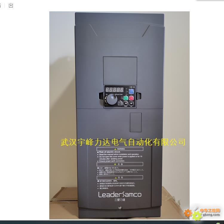

ÈÕ±¾Èý¿Ñ/Èý¿ÑÁ¦´ï±äƵÆ÷NSϵÁÐÓŻݼۣ¬Î人Óî·åÁ¦´ïµçÆø×÷ΪÈý¿ÑÁ¦´ïµÄºÏ×÷»ï°é£¬ÓµÓжþÊ®ÓàÄêµÄÏúÊÛÓëάÐÞ¾­Ñ飬±¸ÓдóÁ¿ÏÖ»õ£¬ÄÜΪ¹ã´óÓû§Ìṩ¿ì½ÝÇÒÓÅÁ¼µÄ·þÎñ¡£
Leadersamco-NSÈý‰¨Á¦ßQϵÁС£ ÎÒ¹«Ë¾ÓµÓÐÒ»ÅúÄêÇáµÄ´óѧÉú×Ô¶¯»¯×¨ÒµÍŶӣ¬¾«Éñ±¥Âú£¬ÈÈÇéÑóÒ磬×öʺñµÀ¡£Õæ³ÏÏ£ÍûÓë¹ã´óÓû§½¨Á¢ÓÅÁ¼µÄºÏ×÷¹ØÏµ¡£
Èý¿ÑÁ¦´ïNS±äƵÆ÷Ϊ˫¹æ¸ñģʽ£¬AÄ£Ê½ÖØÔØÐÍ£¬BģʽÇáÔØÐÍ£¬³ö³§Ä¬ÈÏΪBģʽ£¬¿Éͨ¹ýÐ޸IJÎÊý¸ÄΪAģʽ£¬µ«Êǹ¦ÂʻήµÍÒ»µµ¡£
¾ÙÀý£ºÒÔNS-4A061-BΪÀý£¬³ö³§Ä¬ÈÏΪBģʽÇáÔØ30KW£¬Èç¸ÄΪAÄ£Ê½ÖØÔØÐÍ£¬¹¦Âʼ´Í¬²½¸ü¸ÄΪ22KW£¬Ò²¾ÍÊǹú²úÆ·ÅÆ³£ËµµÄ22G/30PÒ»Ìå»ú¡£
Bģʽ£º400V¼¶ÈýÏàÊäÈ룬0.75kW¡«18.5kW,¹ýÔØ120%/min
Aģʽ£º400V¼¶ÈýÏàÊäÈ룬0.4kW¡«15kW,¹ýÔØ150%/min
ÊÊÓÃÐÐÒµ£º·ÄÖ¯»úе¡¢ÌÕ´É»úе¡¢Ä¾¹¤»úе¡¢ºãѹ¹©Ë®¡¢Ê³Æ·»úе¡¢Ê¯²Ä¼Ó¹¤»úе¡¢µñ¿Ì»ú¡¢¿Õµ÷·ç»úµÈ¡£
Èý¿ÑÁ¦´ï±äƵÆ÷Ó¦Óõ½ÒôÀÖÅçȪ¿ØÖÆÒªµã£º
1¡¢ÒôÀÖÅçȪµÄ¹¤×÷Ô­Àí:
ÒôÀÖÅçȪϵͳÓÉÒôƵ¿ØÖÆÏµÍ³¡¢ÅçȪ¿ØÖÆÏµÍ³ºÍµÆ¹â¿ØÖÆÏµÍ³×é³É£»¸ù¾Ý²¥·ÅµÄÒôÀÖÀ´¿ØÖÆÅçȪˮÖùЧ¹û£¬½«ÊµÊ±²É¼¯µÄÒôÀÖÐźÅͨ¹ý¼ÆËã»ú¿ØÖÆÏµÍ³½øÐÐʶ±ð´¦Àí£¬¿ØÖÆË®±ÃתËÙ¼°¿ØÖÆË®ÏÂËÅ·þ¶¯Á¦»ú¿ØÖƲʵƶ¯×÷£¬ÊµÏÖË®ÐÎÓëÀÖÇúͬ²½±ä»¯£¬ÆäÒôÀÖ¡¢Ë®ÐÎÖ®¼äµÄÏìÓ¦ËÙ¶ÈÐë´ïµ½ºÁÃë¼¶²ÅÄܱÜÃâÏàÓ¦ÖͺóÔì³É¶¯×÷Ê§Õæ¡£
2¡¢ ±äƵÆ÷¿ØÖÆÒªµã
Õû¸öϵͳ²ÉÓõÄÊÇ¿ª»·Ä£ÄâÁ¿¿ØÖÆ¡£
ÒªÇóÅçȪ³öˮʵʱÏìÓ¦£¬³öË®¸ß£¬Ë®ÖùÓÐÁ¦£¬ÐèÒª±äƵÆ÷¿ìËÙÏìÓ¦¼±ËÙ¸ºÔØ£¬ÊµÏÖÎÞÌøÕ¢µÄ×Ô¶¯¼Ó¼õËÙ¹ý³Ì£¬¶Ô±äƵÆ÷¹ýÁ÷ºÍ¹ýÔØÄÜÁ¦ÒªÇó¸ß¡£
°´ÕÕµç»ú¹¦ÂÊ´óСÅäÖÃÏàÓ¦±äƵÆ÷£¬Ö´ÐÐһάºÍ¶þάˮÐÍЧ¹ûµÄË®±Ã½¨Òé·Å´óÈÝÁ¿Ñ¡ÐÍ¡£
¶ÔÓÚ±äÆµÆ÷°²×°ÓëË®±Ã¾àÀë½ÏÔ¶µÄÇé¿ö£¬ÐèÒª¿¼ÂÇ·Å´ó±äƵÆ÷ÈÝÁ¿Ñ¡ÐÍ»òÕß¼Ó×°Êä³öµç¿¹Æ÷ÅäÖá£
3¡¢ Èý¿ÑÁ¦´ï±äƵÆ÷Ó¦ÓÃÓŵ㣺
¸ßÐÔÄÜVF£¬¶ÔÒôÀÖÏìÓ¦¸ß¶Èʵʱ£¬¶¯×÷Ò»ÖÂÐԺã»
ÌØÊâµçÁ÷Ëã·¨£¬Ê¹Ë®Öù¼áͦÃÀ¹Û£¬Ë®ÐÍÆ½ÎÈÕûÆë£»
¼òÒ×PLC¹¦ÄÜÂú×ãСÐÍÅçȪӦÓã»
±äƵÆ÷ÓëÊܿصç»ú¾àÀëÔ¶£¬½ÚÔ¼³É±¾£»
¸ß¾«Â©µçÁ÷Ëã·¨£¬±£»¤µç»ú¼°µçÀÂË𻵣»
Äܾ­ÊÜÅçȪ¼±¼ÓËÙ¡¢¼õËÙʱ¶Ô±äƵÆ÷µÄ´óµçÁ÷³å»÷£»
Èý¿ÑNS²úÆ·Ðͺţº³ö³§Ä¬ÈÏΪPÐÍ£¬¼´ÇáÔØÐÍ£¬·ç»úË®±ÃÐÍ¡£
NS-4A003-B   0.75KW 380V
NS-4A004-B   1.5KW 380V
NS-4A006-B   2.2KW 380V
NS-4A009-B   4.0KW 380V
NS-4A013-B   5.5KW 380V
NS-4A017-B   7.5KW 380V
NS-4A024-B   11KW  380V
NS-4A032-B   15KW  380V
NS-4A038-B   18.5KW 380V
NS-4A046-B   22KW   380V
NS-4A061-B   30KW   380V
NS-4A076-B   37KW   380V
NS-4A092-B   45KW   380V
NS-4A115-B   55KW   380V
NS-4A152-B   75KW   380V
NS-4A173-B   90KW   380V
NS-4A211-B   110KW  380V
NS-4A253-B   132KW  380V
NS-4A304-B   160KW  380V
NS-4A386-B   200KW  380V
NS-4A426-B   220KW  380V
NS-4A472-B   250KW  380V
NS-4A540-B   280KW  380V
NS-4A590-B   315KW  380V
