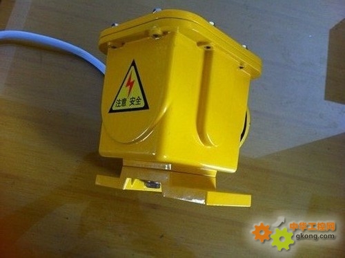

²úÆ·Ãû³Æ£º ¹©Ó¦SL-BƤ´øËºÁÑ×°ÖÃ
ÐÍ ºÅ£º SL-A,SL-B,YHZL-2
¹©Ó¦ÓÅÖÊSL-BƤ´øËºÁÑ×°Öã¬,SL-B˺ÁÑ¿ª¹Ø
SL-B¡¾×ÝÏò˺ÁÑ¿ª¹Ø¡¿×ÝÏò˺Áѱ£»¤×°ÖÃÓÃÓÚ¼ì²âÊäËÍ´ø±¾Éí£¬µ±Æ¤´øÊäËÍ»úÈëÁÏ´æÔÚÈñÆ÷£¬Ê¹ÊäËÍ´ø´ÓÖмä˺ÁÑʱ×Ô¶¯±¨¾¯²¢½ô¼±Í£»ú¡£
SL-BƤ´øËºÁÑ×°ÖøÅÊö£º SL-A,SL-BÔÚÆ¤´ø³öÏÖÓÉÓÚ˺ÁÑ¡¢´Á´©¡¢½»½ç´¦Ë𻵻òÈñÀûÎï͹³öƤ´øÊ±£¬ËºÁÑ¿ª¹ØÄܸø¼àÊÓÈËÔ±Ìṩ±¨¾¯ÐźŻò¹ØµôÊäËÍ»ú¡£
˺ÁÑ¿ª¹Ø³É¶Ô°²×°ÔÚÆ¤´øÁ½²à£¬ÓÉÁ½¶ÎÒÒÏ©ÍâÌ׵ĺ½¿Õ¸ÖË¿ÉþÁ¬½ÓÆðÀ´¡£ÉþµÄÒ»¶ËÓÀ¾Ã¹Ì¶¨ÔÚÖ§³ÅÍмÜÉÏ£¬ÁíÒ»¶ËÁ¬½ÓÔÚ˺ÁÑ¿ª¹ØµÄÀ­»·ÉÏ¡£Á½¶ÎÏßÉþÔÚÆ¤´øÏÂÃæÐгÌÀïÒ»¸ö±ÕºÏµÄ»ØÂ·£¬µÍ°ºÎïÌå»ò˺ÁÑµÄÆ¤´øÐüµõÏÂÀ´¡¢É¨ÂäÒ»Ìõ»òÁ½ÌõÏßÉþʱ£¬¼´Ì½²â³ö¹ÊÕÏ¡£ÒòΪÏßÉþµÄÊÜÁ¦×÷ÓÃÏ£¬Ëü°ÑÀ­»·ÖáÏòÍâÀ­³öȴʹ×ÔÏúÊÖ±úÏòÉϵ¯Æð£¬´Ëʱ»úÄÚÁ½¸ö΢¶¯¿ì¹Ø·¢³ö±¨¾¯»ò¹ØµôÊäËÍ»ú¡£¹ÊÕÏÅųýºó½«×ÔÏúÊÖ±úÍùϰ´£¬ÊÇ»úÄÚµÄ͹ÂÖÖḴλ´ý¿ª»ú¡£
SL-BƤ´øËºÁÑ×°ÖÃÌØµã
½á¹¹¼òµ¥¡¢Àι̣¬²»Ðèά»¤¡£
´ø·À¸¯²ãµÄÖýÂÁÍâ¿Ç¡£
ÖØÔØÎ¢ÐÍ¿ª¹Ø´¥µã¡£
×÷ÓÃÁ¦Ö»Ðè0.9kg¼´¿É´¥·¢¿ª¹Ø¡£
SL-BƤ´øËºÁÑ×°Öü¼Êõ²ÎÊý
ÐͺŠ
SL-BÐÍ£¬2¸ö½ø¿ÚÅ·Ä·Áú΢¶¯¿ª¹Ø
Êä³ö½ÓµãÊýÁ¿
Ò»³£¿ª¡¢Ò»³£±Õ¡¢ÅäÓÃËÄоµçÀ¡¢³¤1.5m£¬ÏßÉ«ºìÀ¼Îª³£¿ª¡¢ºÚ°×Ϊ³£±Õ£¨Ò²¿É¸ù¾ÝÐèÒª½Ó³É³£¿ª»ò³£±ÕÐÎʽ£©
´¥µãÈÝÁ¿
125,250V»ò480VAC¡¢20A
·À»¤µÈ¼¶
 ¿ÇÌå·À³¾¡¢·ÀÓ꣬ÊʺÏÊÒÄÚÍâ°²×°
SL-BƤ´øËºÁÑ×°Öð²×°Óëµ÷ÊÔ
˺ÁÑ¿ª¹ØÉèÖÃÔÚÊÜÁ϶νº´øÏ»º³åÍйõÖ®¼ä¡£
°´Éϰ²×°Ö§¼ÜºÍ˺ÁÑ¿ª¹Ø£¬ËºÁÑ¿ª¹ØµÄÀ­»·ÒªÓ뽺´ø±ßԵͬ¸ß£¬Èô¸ß¶È²»¹»¿ÉÔÚÖ§¼ÜϼÓÉϵæÌú»ò²Û¸Ö£¬²âºÃ¸ß¶ÈºóÔÙ°ÑÖ§¼ÜÓëÖ§×ùº¸ÀΡ£
¹ÒÉÏÀ¹Ë÷£ºÒ»¶Ë´©¹ý˺ÁÑ¿ª¹ØµÄÀ­»·ÓÃË÷¿Û¿ÛËÀ£¬ÁíÒ»¶Ë´©¹ý¶Ô·½ËºÁÑ¿ª¹ØÖ§¼ÜÖмäµÄÔ²¿×´ýÓá£
°²×°ºÃ¶þֻ˺ÁÑ¿ª¹ØºÍ¹ÒÁ½ÌõÀÂË÷¡£ÔÙ¼Ó30¶ÈÍä½Ç´¦°ÑÁ½ÌõÀ¹Ë÷¿ÛÔÚÒ»Æð£¬µ«²»ÄÜ¿ÛËÀÒª»î¶¯¡£
ÊÕ½ôË«·½Ö§¼ÜÖмä¿×ÄÚµÄÀ¹Ë÷È»ºó¿ÛËÀË÷¿Û¡£
À¹Ë÷µÄËɽô£ºÒ»°ã×÷ÓÃÔÚ0.9kg¼´¿É´¥·¢¿ª¹ØÎªÒË¡£
½º´øÔÚºÉÔØÏ³ÁʱҪÓëÀÂÉþ±£³Ö5mm-10mm¼´¿É¡£
