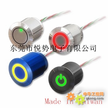

·ÀË®´¥Ãþ¿ª¹Ø£¬´øµÆ´¥Ãþ¿ª¹Ø£¬½ðÊô´¥Ãþ¿ª¹Ø Series YC-TK Touch Key Switches
@ Available in 16, 19, 22mm mounting size with momentary and latching functions in wire or terminal connections. Various marking options are on offer
User-friendly technology senses the touch of a finger and creates an electrical charge to activate the switch. An auto-calibration function ensures the sensor adapts to changing external environments or in automobiles.
Capacitance Technology
Distinctive features:
200mA & 1.5A @ 5 ~ 30VDC
Available in NC-MOM, NO-MOM, NC-NO, NO-NC switch functions
Illuminated and non-illuminated types
IP68 protection class & IK02/IK10 impact resistance
Materials can be chosen from stainless steel, aluminum (with anodized colors) and PC
Ideal for medical and food industries
Minimum 1 million life cycles
RoHS Compliant
