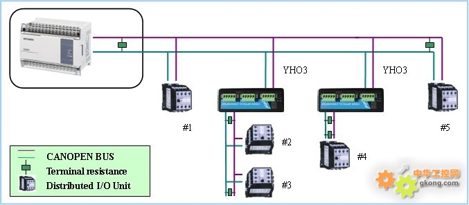

µã¶Ôµã£¨Point to Point£©
Ó¦Óó¡ºÏ£ºÄ³Ð©µ¥¶À·ÖÉ¢µÄ×ÜÏß½Úµã¼äÊܸÉÈÅÑÏÖØÐèÒªµçÆø¸ôÀë»òÐèÒªÔö¼Ó½ÚµãÊýʱ

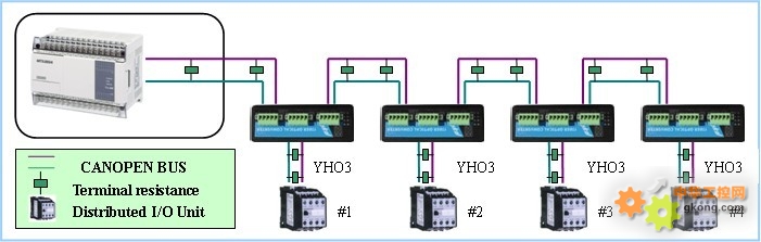

Á´ÐÍ£¨Line£©
Ó¦Óó¡ºÏ£º¶à¸ö×ÜÏß½Úµã¼äÐèÒªÍêÈ«µÄµçÆø¸ôÀ뿹¸ÉÈÅʱ

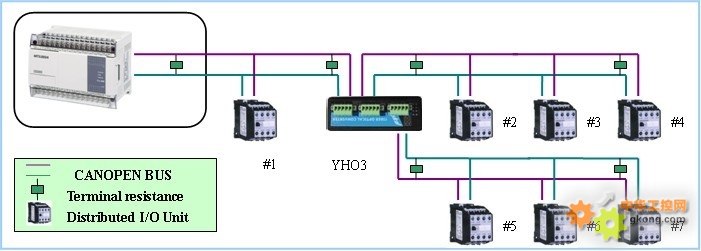

ÐÇÐÍ£¨Star£©
Ó¦Óó¡ºÏ£º¶à¸ö½ÚµãÖ®¼äÐèÒª¸Ä±ä×ÜÏßÁ´ÐÍÍØÆË·½Ê½£¬»òÕß¶à¸ö½Úµã¼äÐèÒªÍêÈ«µÄµçÆø¸ôÀëʱ£»
