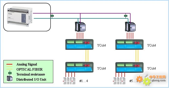

ÍøÂçÍØÆË½á¹¹£º
±¾É豸Åä¶ÔʹÓ㬿ÉÒÔµ¥Ïò£¨µ¥ÏË£©´«Ê䣬´ËʱÉ豸·ÖΪÐźŷ¢ËͶ˺ÍÐźŽÓÊÕ¶Ë£»Ò²¿ÉÒÔË«Ïò£¨Ë«ÏË£©´«Ê䣬´ËʱÉ豸¿ÉÒÔÈÎÒâʹÓã¬É豸²»ÓÃÇø·Ö·¢ËͶ˺ͽÓÊÕ¶Ë¡£
һ·4~20mAµçÁ÷Á¿ÐèÒªÔ¶¾àÀë´«Êäʱ:
ËÄ·4~20mAµçÁ÷Á¿ÐèÒªÔ¶¾àÀë´«Êäʱ:
