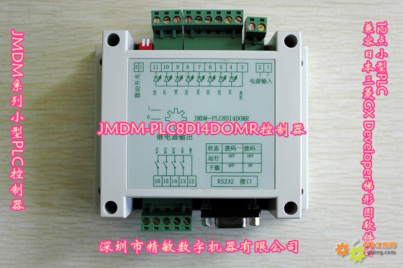

JMDM-PLC8DI4DOMR¼æÈÝÈÕ±¾ÈýÁâGX DeveloperÌÝÐÎͼÈí¼þµÄ12µãСÐÍPLC
JMDM-PLC12DI8DOMR¼æÈÝÈÕ±¾ÈýÁâGX DeveloperÌÝÐÎͼÈí¼þµÄ20µãСÐÍPLC
JMDM-PLC16DI12DOMR¼æÈÝÈÕ±¾ÈýÁâGX DeveloperÌÝÐÎͼÈí¼þµÄ28µãСÐÍPLC
JMDM-PLC22DI16DOMR¼æÈÝÈÕ±¾ÈýÁâGX DeveloperÌÝÐÎͼÈí¼þµÄ38µãСÐÍPLC
