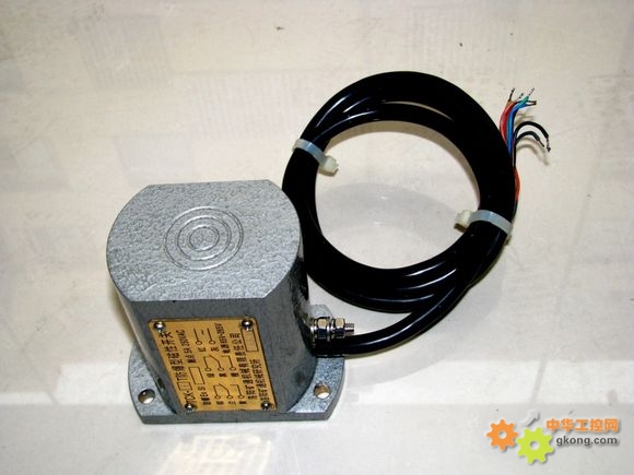

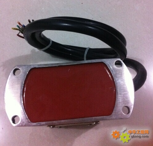

²úÆ·Ãû³Æ£º KGE1-1AP¹ÞÁýµ½Î»¿ª¹Ø£¬´Å¿ª¹Ø
ÐÍ ºÅ£º KGE1-1AP¡¢TCK-1T
KGE1-1AP¿óÓý½·âÐʹŸÐÓ¦¿ª¹Ø¹¤×÷Ô­Àí£ºKGEϵÁдÅÐÔ¿ª¹ØÊÇ·Ç»úе½Ó´¥´ÅÐÔ½Ó½ü¿ª¹Ø¡£ËüÓÉ´Å´«¸ÐÆ÷ºÍµç×ӵ緼°Êä³ö¿ª¹Ø×é³É¡£µ±´ÅÐÔ¼ì²âÌåÓÀ´ÅÌú½øÈë KGE¿ª¹Ø´Å´«¸ÐÆ÷µÄ¸ÐÓ¦ÇøÓò£¬¿¿´Å³¡×÷Ó㬠KGE¿ª¹Ø¶¯×÷£¬Êä³ö¿ª¹ØÐźš£Êä³öÐźŷ´Ó³¼ì²âÌåµÄλÖá¢Ô˶¯·½Ïò£¬×÷¿ØÖÆÏµÍ³µÄÐг̿ØÖÆÐźš£
KGE1-1AP¿óÓý½·âÐʹŸÐÓ¦¿ª¹Ø²úÆ·ÓÅÊÆ£º
±¾²úÆ·²ÉÓÃвÄÁÏ£¬¹¦ºÄÖ»ÓÐ50ºÁÍß¡£
±¾²úÆ·²ÉÓõç·¿¹¸ÉÈż¼Êõ£¬¼õÉÙÐÅºÅµÄ´í±¨£¬Î󱨡£
±¾²úÆ·²ÉÓÃй¤ÒÕ£¬Ìṩ¶¨Î»¾«¶È£¬¶¨Î»¾«¶È¿ØÖÆÔÚ3ºÁÃ×ÄÚ¡£
KGE1-1AP¿óÓý½·âÐʹŸÐÓ¦¿ª¹Ø´Å¿ª¹ØÐÔÄܲÎÊý£º
1¡¢¹©µçµçѹ£ºAC 85~265v(110v·À±¬ÐÍ£©¡£
2¡¢´¥µã²ÎÊý£º127v  2A ¡£
3¡¢´¥µã¸öÊý£ºÁ½×é³£¿ª£¬³£±Õµã¡£
4¡¢ËÙ¶ÈÏìÓ¦£º¿ÉÒÔÂú×ã30M/SµÄËÙ¶ÈÒªÇó¡£
5¡¢¹¤×÷´ÎÊý£º´¥µãµÄ»úеÊÙÃü¿ÉÒÔ´ïµ½10Íò´Î¡£
KGE¿óÓý½·âÐʹŸÐÓ¦¿ª¹Ø×¨ÒµÓë¸÷ÖÖ×Ô¶¯µç¿ØÉ豸ÅäºÏʹÓ㻿ÉÒÔΪ¿óɽµç¿ØÉ豸ÌṩÏàÓ¦µÄµ½Î»£¬¼õËÙ£¬¼ÓËÙµÈÐźţ»ÓÐЧÌá¸ßµç¿ØµÄ×Ô¶¯»¯£¬ºÍ¶¨Î»¾«¶È¡£
Ö÷ÒªÓÃÓÚ¿ó¾®¾®Í²ÖУ¬³£ÓõıðÃûÓÐKGE1¾®Í²¿ª¹Ø £¬TCK¾®Í²¿ª¹Ø£¬KGE1µ½Î»¿ª¹Ø£¬TCKµ½Î»¿ª¹Ø£¬KGE1¶Ô¹à¿ª¹Ø£¬TCK¶Ô¹à¿ª¹Ø
KGE1-1±íʾһ×é´¥µã¼´5оÏߣ¨1×é³£¿ª£¬1×é³£±Õ£©
KGE1-2±íʾ¶þ×é´¥µã¼´8оÏߣ¨2×é³£¿ª£¬2×é³£±Õ£©
±¾¹«Ë¾Éú²úKGEϵÁнӽü´Å¿ª¹Ø£¬Í¬Ê±Éú²úKGE-2£¬KGE-3£¬KGE-4ÌØÊâÐÍ´Å¿ª¹Ø¡£
¿óÓþ®Í²¿ª¹ØÐͺţºKGE1-1AP¡¢TCK-1¡¢TCK-1P¡¢TCK-2P¡¢TCK-3P¡¢TCK-4P ¡¢TCK-1T¡¢TCK-2T¡¢TCK-3T¡¢TCK-4P
