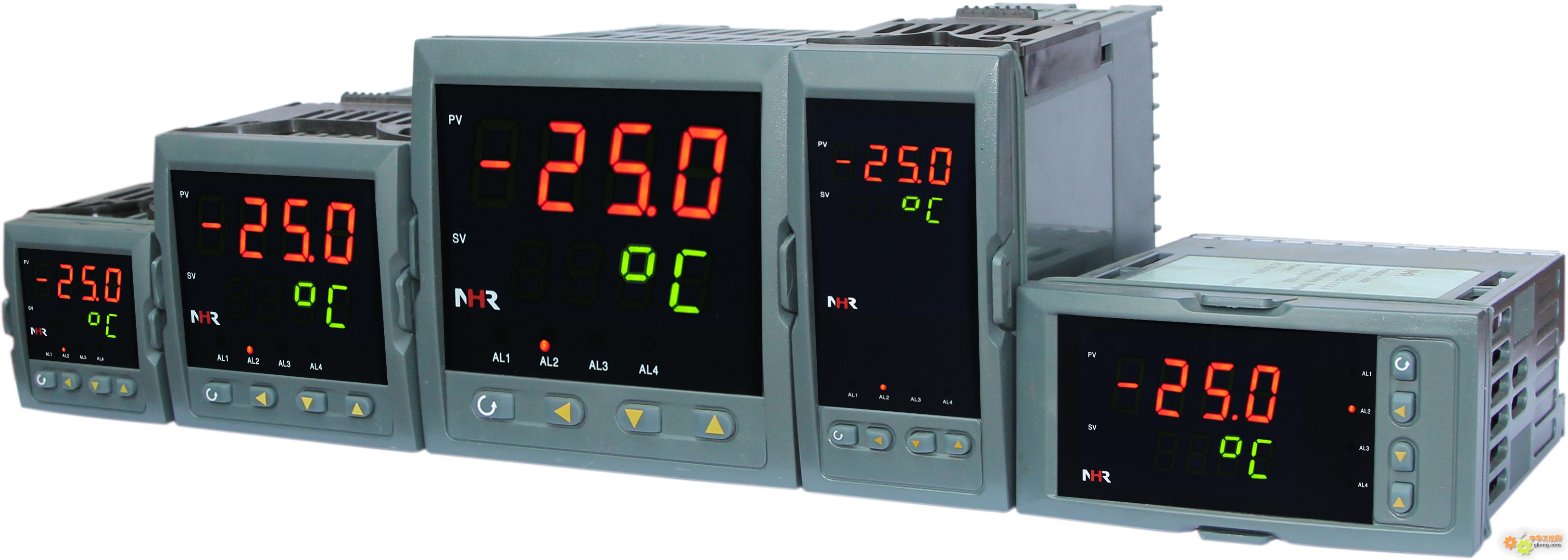

¸ÅÊö
    NHR-5100ϵÁе¥»ØÂ·Êý×ÖÏÔʾ¿ØÖÆÒÇÕë¶ÔÏÖ³¡Î¶ȡ¢Ñ¹Á¦¡¢ÒºÎ»¡¢Ëٶȵȸ÷ÖÖÐźŽøÐвɼ¯¡¢ÏÔʾ¡¢¿ØÖÆ¡¢Ô¶´«¡¢Í¨Ñ¶¡¢´òÓ¡µÈ´¦Àí£¬¹¹³ÉÊý×ֲɼ¯ÏµÍ³¼°¿ØÖÆÏµÍ³£¬¹ã·ºÔËÓÃÓÚµçÁ¦¡¢Ê¯»¯¡¢Ò±½ð¡¢ÇṤ¡¢ÖÆÒ©¡¢º½¿ÕµÈÖî¶àÁìÓò¡£
µ¥Â·ÊäÈ룬˫ÆÁLEDÊýÂëÏÔʾ£¬ÇÒ´øÓйâÖùÄ£Äâָʾ¹¦ÄÜ£¨0¡«100£¥£©¡£
¾ß±¸36ÖÖÐźÅÊäÈ빦ÄÜ£¬¿ÉÈÎÒâÑ¡ÔñÊäÈëÐźÅÀàÐÍ£»0.2£¥¼¶²âÁ¿¾«¶È¡£
Èȵç×è\ÈȵçżÐźŷֱæÂÊ¿ÉÇл»£º1¡æ»ò0.1¡æ¡£
¾ß±¸“ÉÏÏÂÏÞ±¨¾¯”¡¢“ÑÓ³Ù±¨¾¯”¡¢“¶ÏÏß±¨¾¯”¡¢“ÉÁ˸±¨¾¯”µÈ±¨¾¯¹¦ÄÜ£¬´øLED±¨¾¯µÆÖ¸Ê¾¡£
¾ßÓеçѹ¡¢µçÁ÷±äËÍÊä³öÐźſÉÑ¡¡£
Ö§³ÖRS485¡¢RS232´®Ðнӿڣ¬²ÉÓñê×¼MODBUS RTUͨѶЭÒé¡£
ÒDZí¿É´øRS232C´òÓ¡¹¦ÄÜ£¬¾ßÓÐÊÖ¶¯´òÓ¡¡¢¶¨Ê±´òÓ¡¡¢±¨¾¯´òÓ¡µÈ¹¦ÄÜ¡£
´øDC24VÀ¡µçÊä³ö£¬ÎªÏÖ³¡±äËÍÆ÷Åäµç¡£
ÊäÈë¡¢Êä³ö¡¢µçÔ´¡¢Í¨Ñ¶Ï໥֮¼ä²ÉÓùâµç¸ôÀë¼¼Êõ¡£
¾ß±¸¶àÖÖÍâÐγߴ缰Ñùʽ¹©Óû§Ñ¡Ôñ¡£
²ÎÊýÉ趨ÃÜÂëËø¶¨¡¢²ÎÊýÉèÖöϵçÓÀ¾Ã±£´æ£¬¾ß±¸²ÎÊý»Ö¸´³ö³§É趨¹¦ÄÜ¡£
