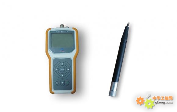

ÓíɽÐÂÒ»´úÓ«¹â·¨ÈÜÑõÒÇ£¬²ÉÓÃÁ˹ú¼ÊÁìÏȵÄÓ«¹âÊÙÃü¼¼Êõ¡£°üÀ¨Ò»¸öÆä×ÔÖ÷Ñз¢¡¢¹ú¼ÊÁìÏȵÄÓ«¹â·¨ÈܽâÑõ´«¸ÐÆ÷ºÍÒ»¸öÓÉÓíɽ¶À´´µÄÖÇÄÜÒÇ±í¿ØÖÆÆ÷£¨Smart Meter£©¡£¿ÉÒÔ¿ìËÙ׼ȷµØ²âÁ¿³öÈܽâÑõº¬Á¿£¬¾ß±¸Ë®ÎºʹóÆøÑ¹Á¦×Ô¶¯²¹³¥¹¦ÄÜ£¬Í¬Ê±£¬ËüÒ²¿ÉÒÔºÍÖÇÄÜÊÖ»úÒÔ¼°Æ½°åµçÄÔͨ¹ýÀ¶ÑÀ½øÐÐÁ¬½Ó£¬ÔÚSmart Meter appµÄÖ§³ÖÏÂÓÉÊÖ»ú»òÊÇÆ½°åÀ´¿ØÖÆ£¬ÊµÏÖÐí¶à´«Í³ÒDZíÎÞ·¨ÊµÏֵŦÄÜ¡£
²úÆ·ÌØµã
- Êý×Ö´«¸ÐÆ÷£¬RS485Êä³ö£¬Ö§³ÖMODBUS
- ÎÞĤ£¬ÎÞÐèµç½âÒº£¬ÎÞ¸ÉÈÅ£¬ÎÞÐèÆµ·±Ð£×¼
- ²»»áÏûºÄÑõ£¬Ã»ÓÐÁ÷ËÙÏÞÖÆ
- ÄÚÖÃζȼ°ÆøÑ¹´«¸ÐÆ÷£¬×Ô¶¯ÎÂ¶ÈÆøÑ¹²¹³¥

²âÁ¿Á¿³Ì
0-20mg/L or 0-200% air Sat.
²âÁ¿¾«¶È
1%
ÏìӦʱ¼ä
10 sec
´«¸ÐÆ÷Æ¯ÒÆ
<1% per year
¹¤×÷ζȷ¶Î§
0¡«50¡æ
ζȾ«¶È
±0.2¡æ
ÆøÑ¹²¹³¥
ÒDZíÄÚÖã¬×Ô¶¯²¹³¥50~115kPa
ζÈ&ÆøÑ¹²¹³¥
Build-in & Automatic
´«¸ÐÆ÷³ß´ç
Φ16×180mm
¿ØÖÆÆ÷³ß´ç
166 x 84 x 32mm
Êý¾Ý´æ´¢
Ö§³Ö
Óû§Ð£×¼
Ò»µã»òÁ½µãУ׼
